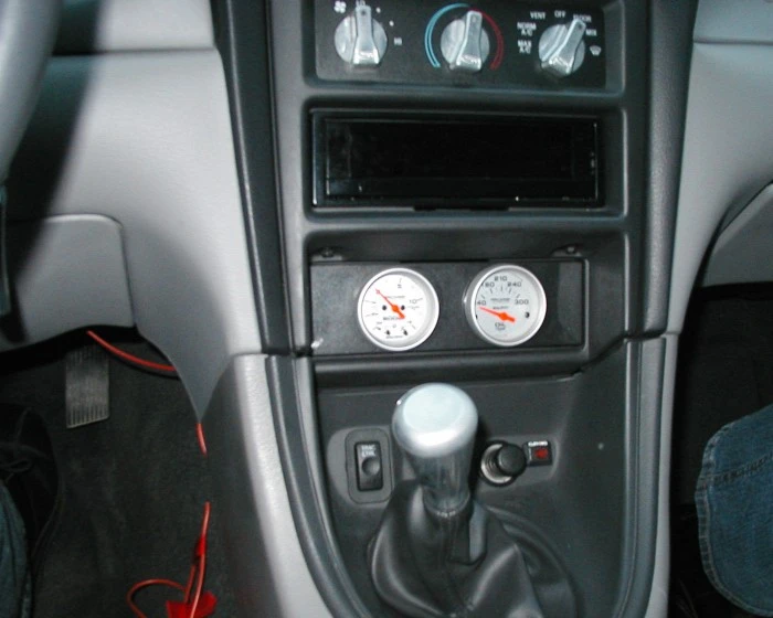

BTW: here's a picture where I mounted the gauges. It is a self-fabricated pod made of an old radio-bezel, which I cutted and coated.
