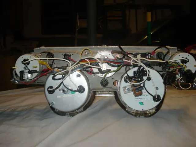

I originally checked the signal and was reading 85 ohms at the end of the wire, furtherest distance from the tank as it got to the gauge (I thought the tank was completely empty but it wasn't as I filled it to the top with only 5 gallons). I'll try the resistance as the wire leaves the tank. Maybe the wire is so old it is at a higher resistance now due to age
I used the the original wire loom and did NO splicing. I used the existing pig tail and attached it directly to the back of the gauge (perfect fit). The exisiting wires ends are female and the gauge connections are male. The only splicing I did was to remove the dash lights (blue with red stripe wire) and hooked up the lights using these wires.
Check out wiring:

I measured the resistance at the sender with power on and it was reading 85 ohms of resistance. SOes this really mean that me float and sensor in the tank is no longer good? I can't believe it stopped working correctly as I made this upgrade. But, I guess that's the nature of the hobby.

I see the voltage regulator mounted to the back of your tach. Is this an old pic? I believe you said that you were running the gauges off of straight 12V, which would be correct. You don't want the CVR anymore.
The resistance gets higher as the fuel level decreases, so it would seem that either you're totally empty (I think you said you're totally full) or may have a bad sending unit.
Can someone else chime in about sending unit testing? It's been a while since I've messed with a stock one. Also try doing a forum search about this.
You are correct in that you see the CVR, but it is only there so that I don't lose it. It's not hooked up to anything.
