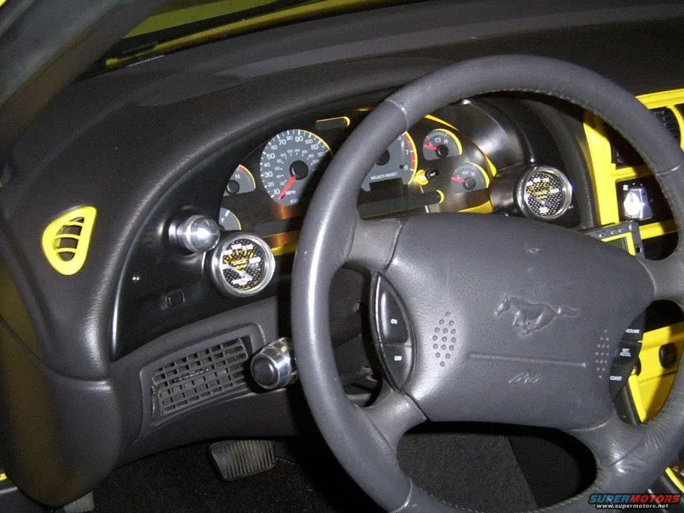

I've got the autometer. Right now I only have the boost gauge in, the FP gauge is sitting in the garage next to my new fuel rail w/ the schrader valve in it.
I went with the carbon series, just oil pressure ant water temp to replace the idiot lights. If you notice I have placed a switch in the detent below the headlight switch. I added a temp sensor in the t used for the oil pressure sensor and both sensors are wired through the switch to the water temp gauge so witht the flip of a switch I get water and oil temps.
I didn't quite catch what you did with the T thing but I'm glad you posted that pic. I now see what those screw holes look like, sort of. Are the screws necessary to mount that thing in place? Or are they there for some other application?

They're there to mount it.
Not a great pic, but you get the idea.
Well to clarify, when you install an electric oil pressure gauge you need to install the sensor in a tee so it points forward instead of down (without tee) or it places the sensor almost in contact with the sway bar. Since the pressure sensor uses the forward facing inlet there is still an opening pointing down that you need to plug. I chose to plug it with a temp sensor and have both water temp and oil temp sensors wired through a SPDT on-on switch that allows me to check both temps using only 1 gauge by changing the switch position on the dash.
Got'cha. Two senders, one gauge. Neat. That gives me a second option. I could go with the single gauge mounting pod that goes around the steering column, and only have to buy one temperature gauge, but hook up a water temp and a transmission fluid temp sender with a SPDT switch.
