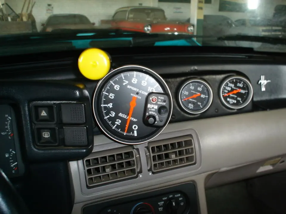

Hey everyone, Today i wen't out to start my 91 Coupe this morning and i smelled a oil burning smell so i shut the car off and poped the hood. I looked and found out that my oil pressure gauge line has been burned off by the headers and there was oil everywhere, Not sure how it ended up on the headers but it was a plastic line. I traced the line threw the firewall and it's going to my autometer sport comp gauge so i want to replace the line ASAP. I was wandering how easy it is to put a new line in? I am wanting to get a stainless steel line so this don't happen again but i'm not sure what size/gauge i need or where to get one...What size fitting ect...Also it needs to fit where my oil pressure gauge is in the housing (To the right of the Tach). I really need help PLEASE anyone:flag:

Hey thanks for the help! Thing is i didn't know it was on the header untill it was too late lol...Anyways i wen't to the local auto parts store and purchased the line...The line went in easy as can be (Took a little while lol) I carefully mounted it away from the header. But thanks for the help guys! Oh and as far as electric i might go that route in the future cuz iv'e herd good things about them.:flag:
