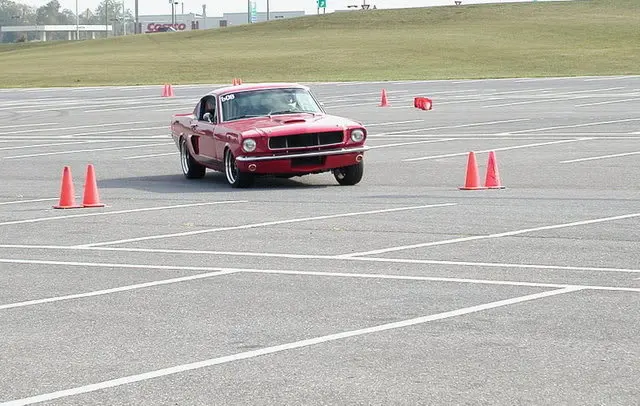

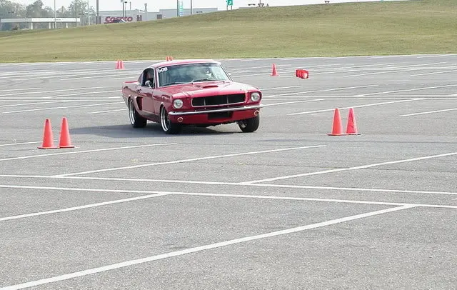

As for the fiberglass composite leaf springs - http://flex-a-form.com/ - they are supposed to respond much quicker then steel, but I'm not sure how adjustable they are. Evidentally you are not supposed to use aluminium lowering blocks to adjust your ride height with fiberglass leaf springs. And I would assume a watts link or panhard bar would be mandatory.
Your set-up sounds similar to mine, but they slap me in CP, because of my T-5 (as if I would ever get to 3rd in an autoX event) and fiberglass trunk deck.
Good luck and hope you get your car back and get out on the AutoX / Open Track.
Tim

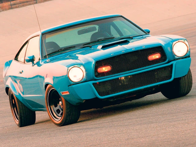

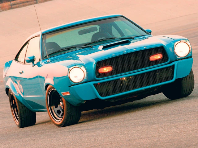

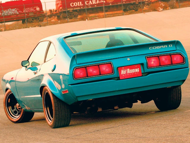

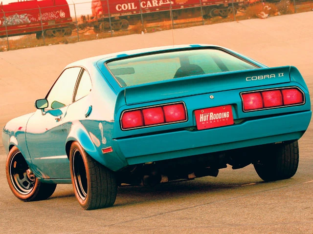

I read an article 6 months ago in PHR on a mustang II with a set of Flex a forms. It pulled over 1g. The guy was using it to auto x.
PHR tested it "as the fastest car" that they had ever tested at whatever track they use. The motor was still pretty stock but it had a set of wilwoods on all 4 corners and a set of auto x tires front and back. The front sup just had a different set of springs and shocks. It seemed pretty basic.
The guy only had $6000 in the whole project.:hail2:
PHR's article. :D
Nice car!
