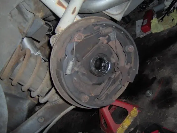

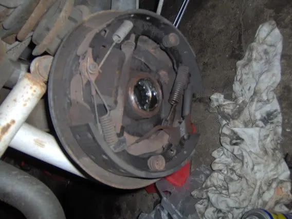

Uh oh,really would need a visual.

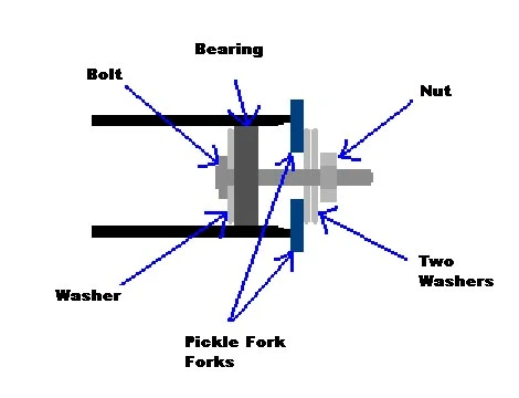

I just did mine and what I did since I didn't have a slide hammer was use a long bold about 4" and about 3-4 washers that were just slightly smaller than the bearing, a nut and pickle fork (you could use anything that will span the outside lips of the housing and let the bolt go through the center) The pickle fork is tapered so it tends to pull at an angle but it still worked. Next put a washer on the bolt and then run the nut on just a little way. Then fling that up the inside of the housing, it should pop the end out the other side of the bearing but the washer will be behind it. Next take the nut off, put two washers on the bolt then run the nut back on a little. Then take the pickle fork and place it under the two washers and across the outside of the flange. Once thats supported start tightening the nut down and keep going untill the bearing pops out.

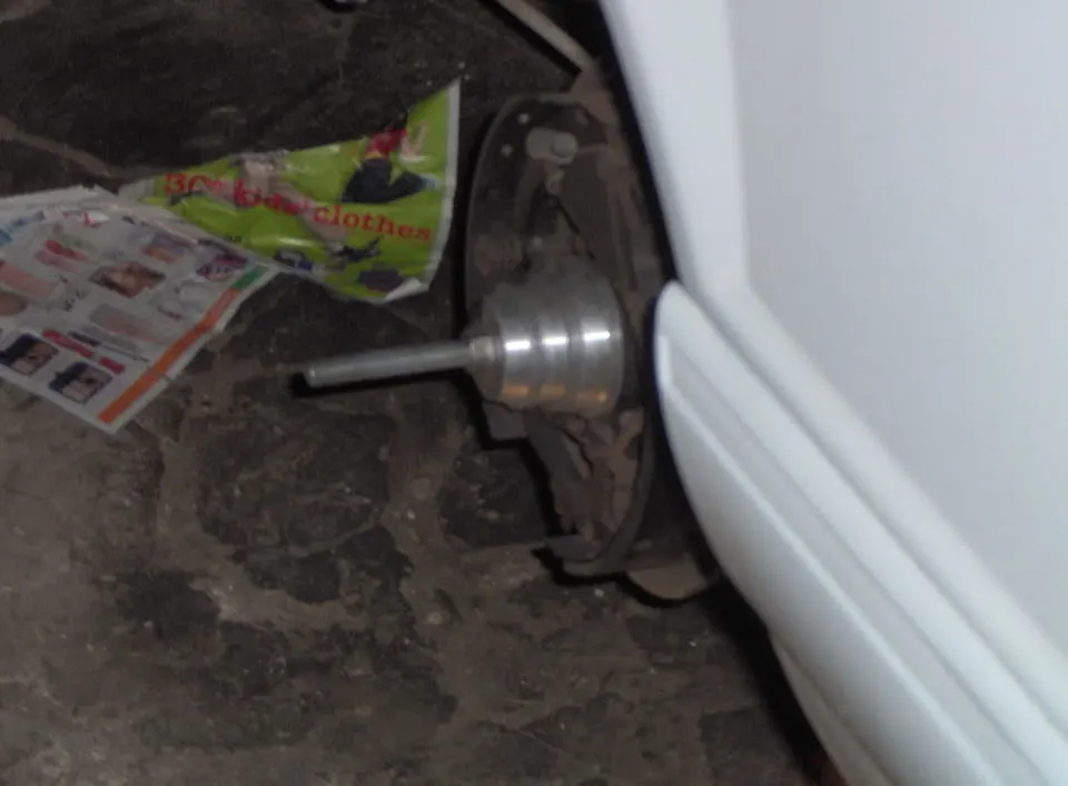

ok this is similar to the setup you told me but i have a race installer instead. im gunna put more on tommorrow, and im gunna use my nieghbors airgun, i wont damge the axle if its too tight will i?
