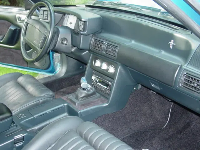

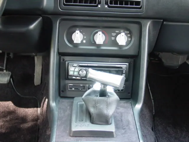

Here is a pic of mine. I installed it over a year ago and I haven’t had any problems with the cable stretching or with it missing gears. I like it much better than the stock shifter because it locks out at every gear so you don't go from 1st straight to OD. It's also alot better looking than the stock shifter IMO.
