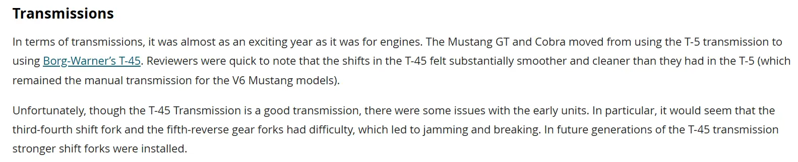

I'm not too familiar with the transmissions they came with, but I have some experience with T5s. Looking through CJ Pony Parts site, they say that the 96 started using the T45 which had issues with some of the shift forks. Here's a link to their page, they mention the transmissions about halfway down the page.
So, if I had to guess, it sounds like your transmission will likely need rebuilt and/or replaced. I'm sorry, that's probably not the news you wanted to hear.... :hide:

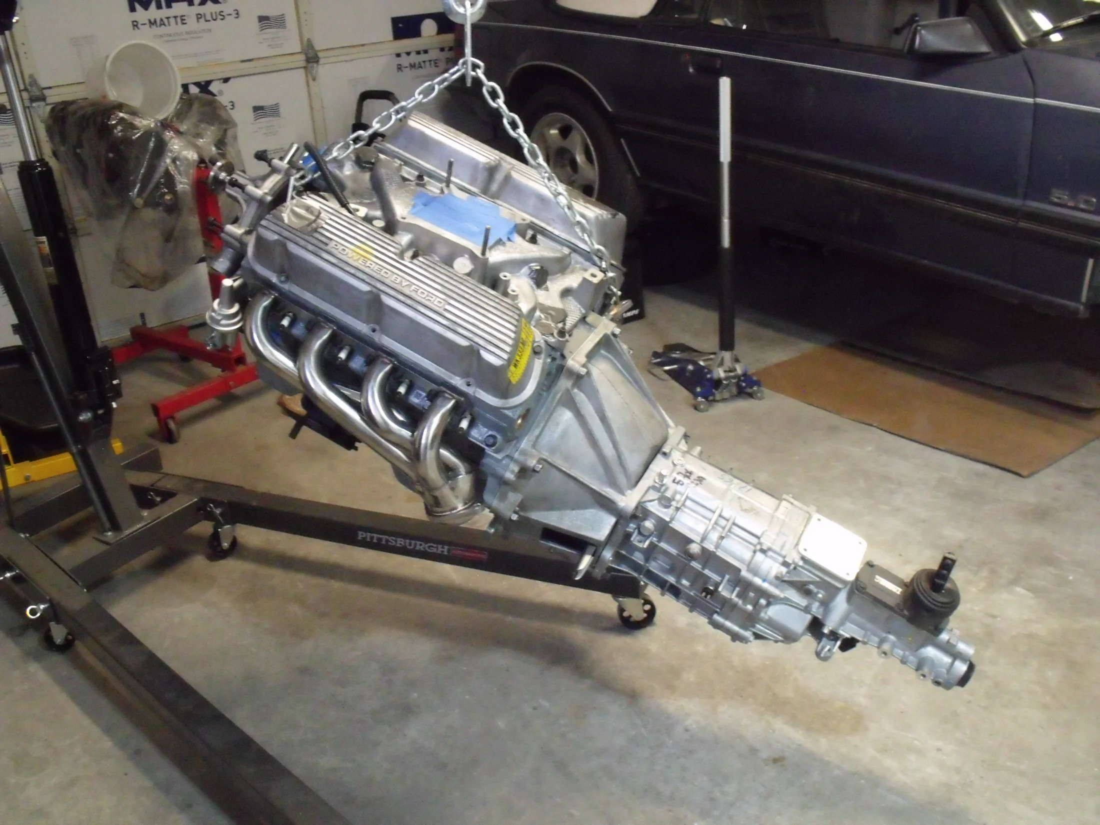

I bought one for the TKX that I just finished up installing here:
Hands down the best shifter I have ever owned. Will never knock the Pro 5.0 as it is a solid shifter but the MGW just makes the shifts feel more natural.
