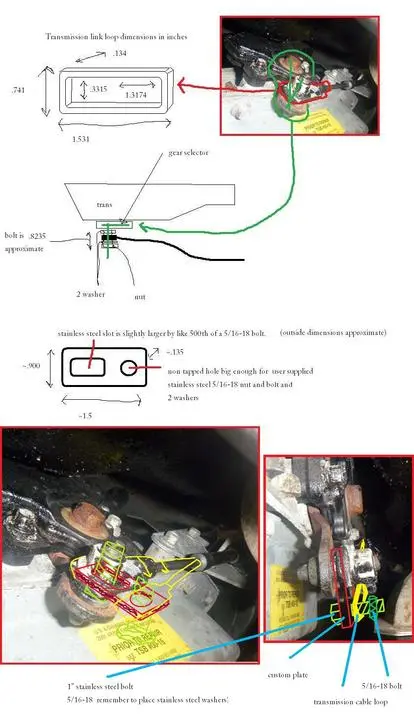

above you can see my crappy ms paint picture. in part 1. you see the blue transmission cable being stretched when its in park. the park should be about 5 more degrees to the left to be truly in park. but the cable is not long enough.
my plan is to take the cable in picture 2 and to dremel out the loop a little bit on the inner side and end up with a cable that looks like picture 3.
does this make sense? should i do this, or should i buy another cable? what do you recommend. I literally need about 1 or 2 centimeters of slack and i think the dremmel will do it.

I ended up not dremmeling but had a machine shop custom make me a piece.
I rode around like that for a while. it was perfectly fine, but I was unhappy with it being it was a hacked together fix and I wanted perfect. I ended up ultimately taking it to a performance shop and had them make a new end piece physically connected to the existing cable.
