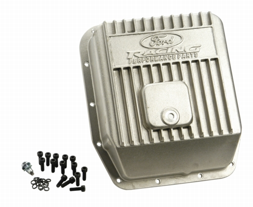

Ford Racing Parts has one that adds two quarts to stock capacity and has a drain plug:
Thanks Streetstang03, didn't see that little link in the word "one".
The FRPP pan above is 195 dollars. At least accordingly to that link. It also does not come with a new pan gasket. The one from B&M I gave the link for above is only 164.95 and it does come with a new gasket. Not to mention the the B&M increases fluid capacity by 3qts, compared to the FRPP one that only increases it by 2qts.
