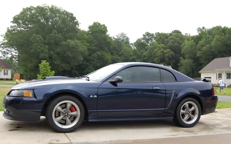

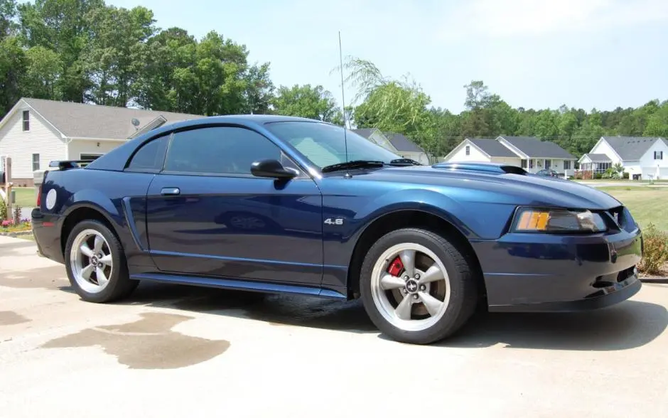

Here's before and after. The second pic also has my new BFG 255/45/17's.

Hmmmm I think my C springs actually lowered my car a bit more than those B Springs. I would say take another pic in a week once the suspension has settled in. Will probably drop another .5 inches if it's a fresh job.
Uh the c's are progressive.
The back's are, I'm talking the front, which for the C-Springs are linear not helping for drag racing.
C-springs
650 Front spring rate
200/300 Rear spring rate.
The Ford C springs have a linear rate front spring, which is great for improving street handling and cornering.
B-Springs:
425-530 lb/in front spring rate
200-300 lb/in rear spring rate
The Ford B springs have a slightly different spring rating setup than the Ford C springs because of their progressive rate technology, which is engineered to provide a soft/comfortable ride, while still offering sporty handling.
what I was saying - is that I installed the bullitt suspension package with C Springs instead of the bullitt springs. Would that cause my car to sit lower than regular GT with just C springs? My car seems to look like its lower.
