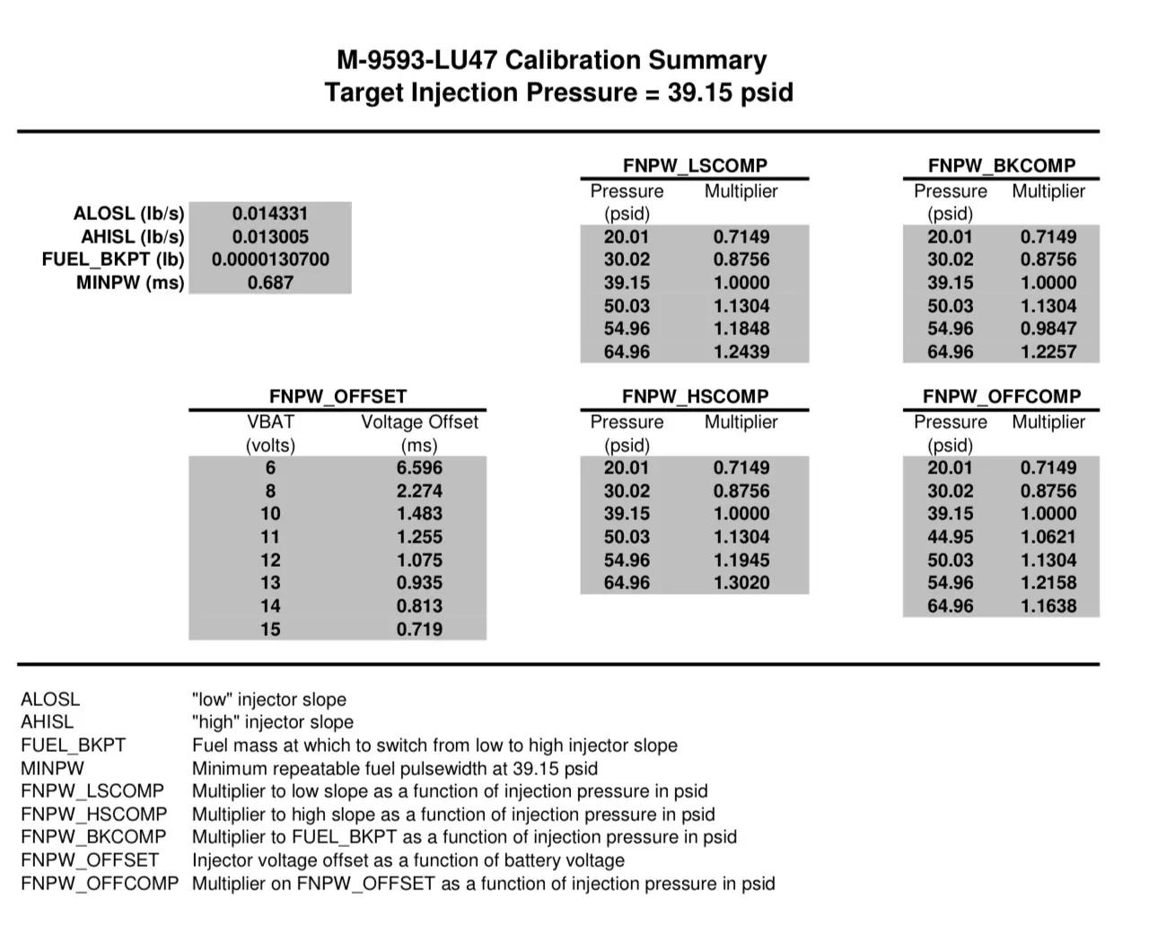

In terms of aftermarket tuning, if you want to run a higher pressure you typically have to use offset compensation for the injector settings.
For example with my 47#er. I set mine as close to 39.15 to avoid having to do offset calcs

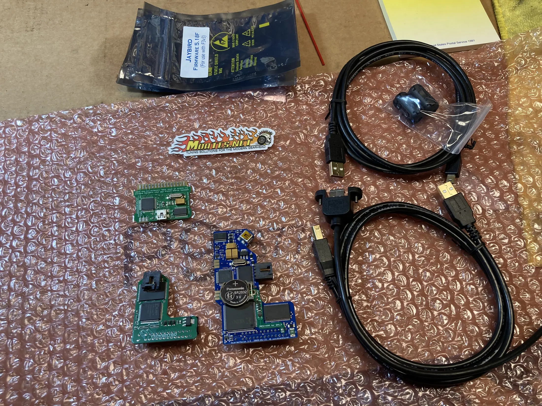

I got an email from Moates that my chips are in the possession of UPS and on their way back to me. No indication of any identified faults in the email, just shipping information. They’re scheduled to be here Monday, 10/12. When I open the package I’ll let you know if there’s any information regarding what may have been wrong.
Got my package from Moates today. There’s nothing in the box about them finding anything specific wrong with the stuff I sent them. The box just contains all new stuff. I’m happy with the process entirely! Time to start tinkering. I’ll post back when I get something done.

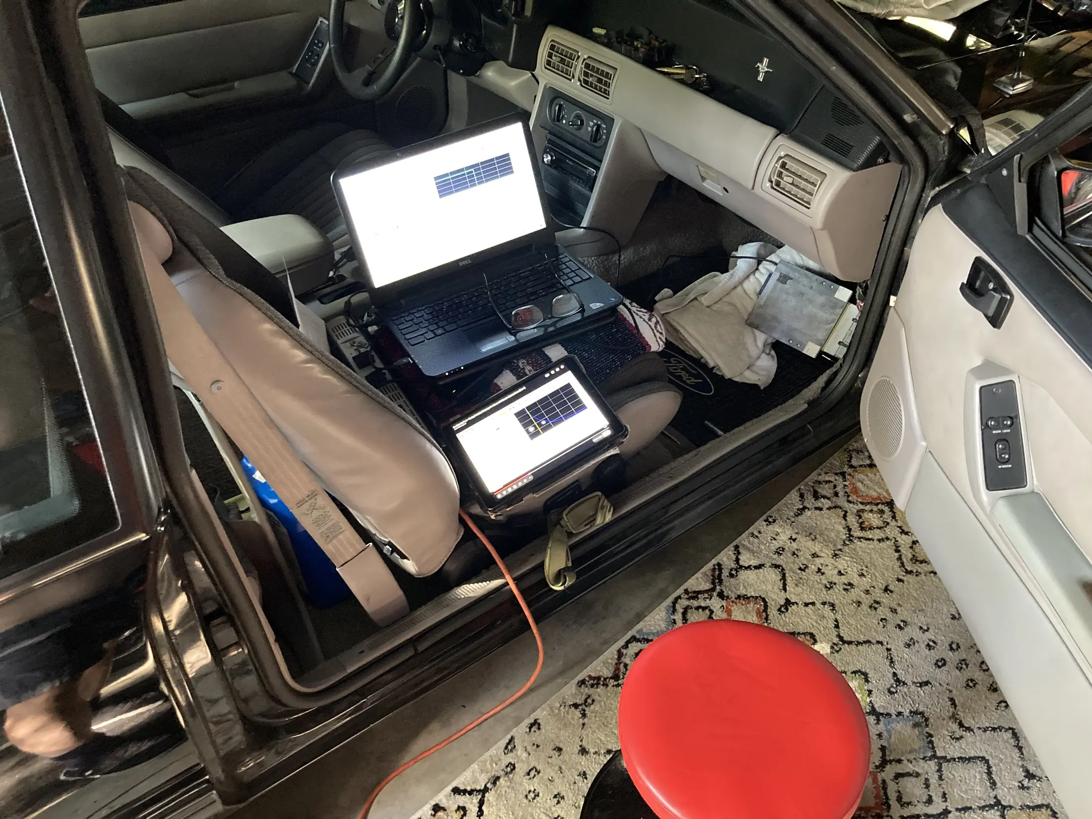

The new QH took the base tune and it functions normally when installed. Car started right up and idled normally. I’ve got the laptop connected in the car and have ran my first data logs. I have the signal wire from the wideband wires up and I need to activate it in the BE software by entering the specific transfer rates for PLX brand wideband. I have injector data to enter as well a a complete data set that came with the MAF. I’m under way and making progress.

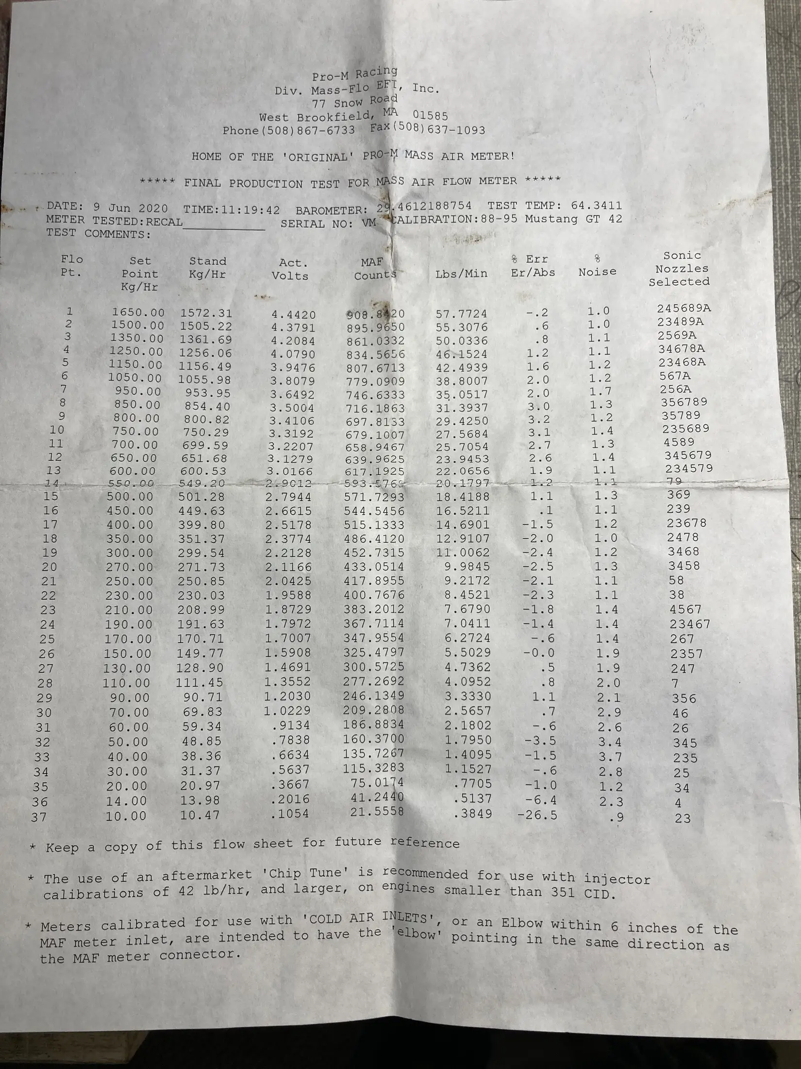

Got my injector specs in. I’m now squeezing the MAF data in. My sheet has 37 data points but the ECU only allows 30. I’m learning the MAF fitting tool in BE now. I did punch a few numbers in from the idle range and ran a data log to see my MAF idle volts and airflow. With this info I can exclude at least 2 lines of data below the idle range. Ill
Compress the remaining 35 down to 28 lines using the MAF fitter. It’s starting and idling very nicely so far.

I successfully got the data from the MAF sheet compressed into the data transfer table in BE. I have also adjusted the pulse width for startup cranking fuel. Since my 42lb injectors are roughly double the flow of the stock 29’s, I cut the startup pulse width in half. I believe I’ve also correctly configured BE to display wideband data on the data logs but I haven’t verified that yet. When I load these changes and start the engine I’ll report back.
Loaded the changes and the car starts and idles very nicely at 700ish. Cold starts and hot restarts are good with no surging. Drives great no stalling in low speed maneuvers like 3point turn. No stalling in any conditions while using AC. Power feels as good as ever or better with AFR in 12.5 range WOT. Before to get that AFR I had to crank the fuel pressure up significantly. 39 psi now and the ECU is handling the enrichment properly. This is the first time I’ve had this MAF and these injectors properly dialed in and it’s definitely noticeable to the positive side. If a pro tuner gave me my car back running like this I’d have no complaints whatsoever. There’s a couple other things I can do to fine tune and prepare tuning in the blower. I’ll be keeping this NA tune on file for future use in case the blower setup ever needs to be sidelined. I’m very happy with the car right now
