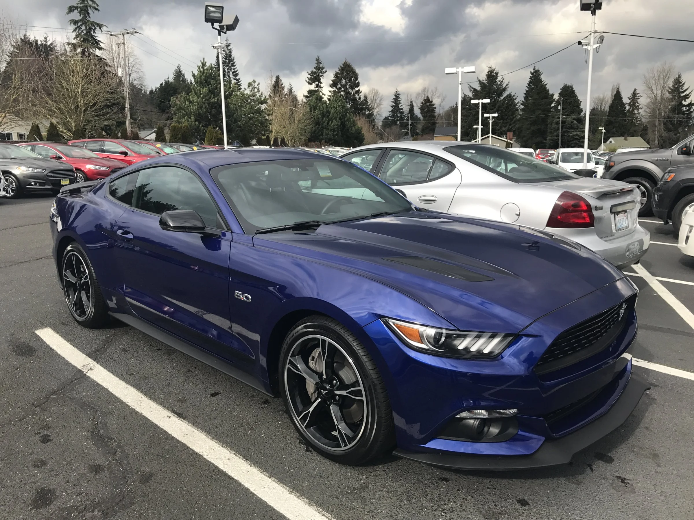

Guys its been awhile but i'm back. I've had several mustangs in the past including, 2004 Cobra, 2001 Saleen (non supercharged), 96 Cobra, 91 5.0. So its been awhile and I just picked up 2016 Cali Edition GT 6-speed. It's a daily driver so I dont want to go too crazy. Any suggestions? Recommendations? Anything I should know. This was my start point. I'm open to suggestions
1. Steeda shifter -s550-mustang-tri-ax-short-throw-shifter-2015
2. Steeda clutch sprint
3. Ford Performance Pack 1]
4. Roush- I want to gain some extra sound but nothing crazy.
5. Ford Performance Street Handling Pack- this would be a little later down the line.
