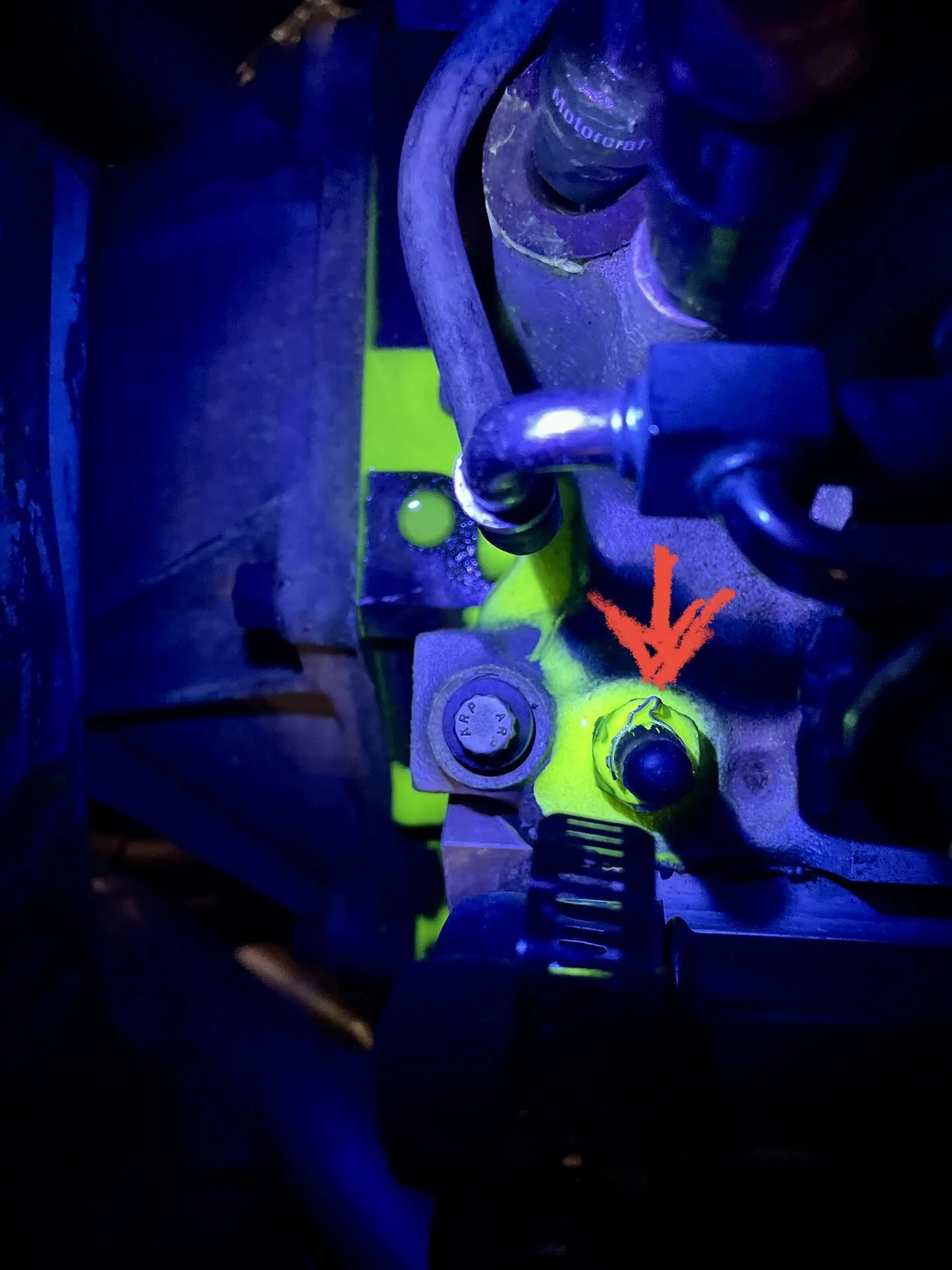

So poured it in gave it crank and let it run for a second. Think I’ve found the culprit. Only spot I could see, everything else was clean and no dye. Not sure why unless the plug just cracked, hopefully can reach it and re plug it.Did you get it done?
I’m not visualizing this area, but it rocks that you found it! (Is that the adapter for the EGR coolant line at the passenger back of the intake?)So poured it in gave it crank and let it run for a second. Think I’ve found the culprit. Only spot I could see, everything else was clean and no dye. Not sure why unless the plug just cracked, hopefully can reach it and re plug it.

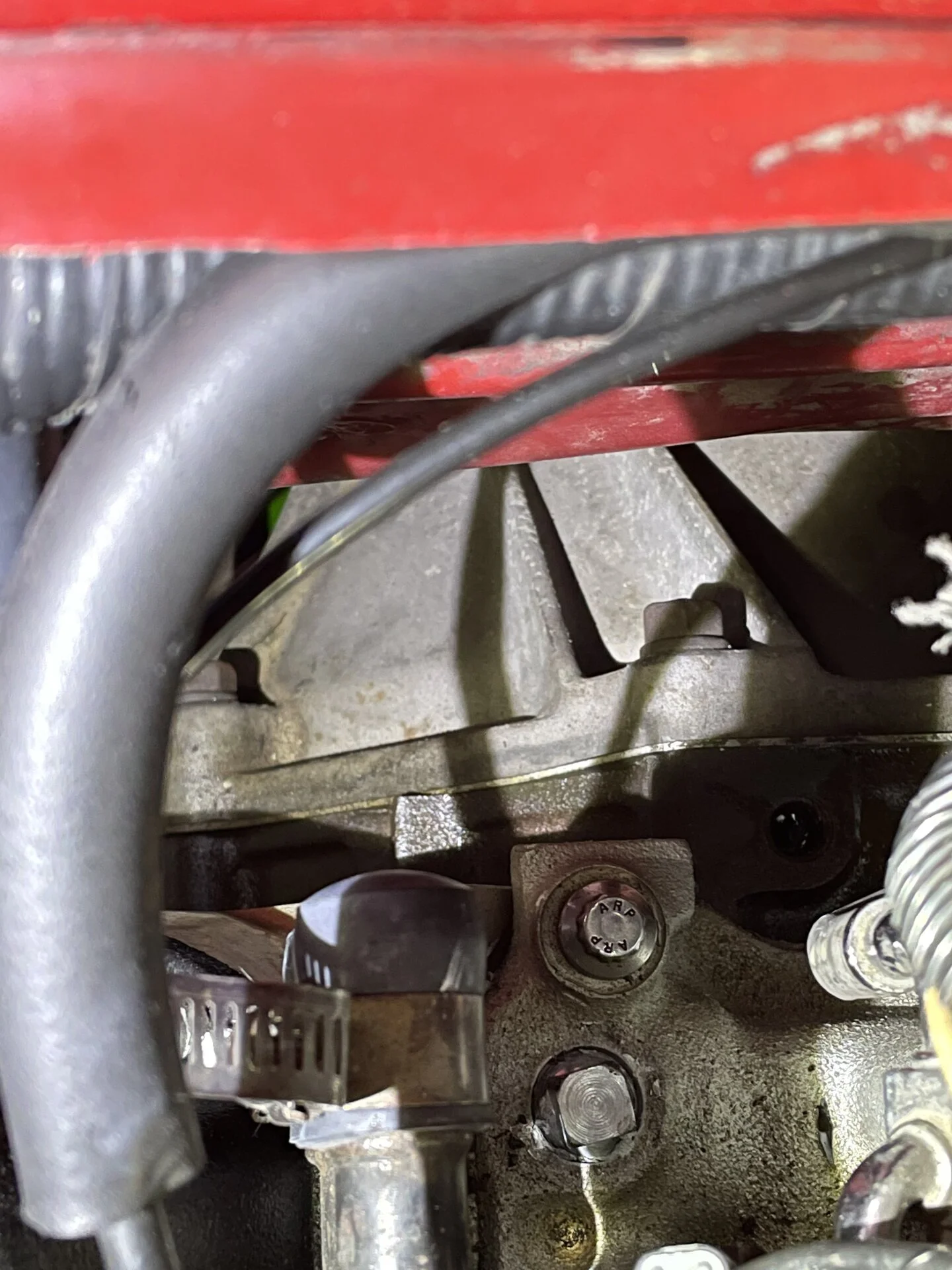

Now it looks familiar. My PCV valve was out like that for an extended, but undetermined time.Your PCV is popped out as well
YupRt rear part of the lower intake right?
yeah I think I pulled trying to get the salt & peppers out of the way to shine the light back there!! Probably why the car started to run weird when I was letting the UV dye spread through the coolant!!Your PCV is popped out as well
Yea, well just wrapped the button some of the Teflon tape and a little pipe dope. Ran the car yesterday for a bit, all was clean no leaks noted!!Did you put thread sealer on it?
glad you found it ,and fixed it.Yea, well just wrapped the button some of the Teflon tape and a little pipe dope. Ran the car yesterday for a bit, all was clean no leaks noted!!
