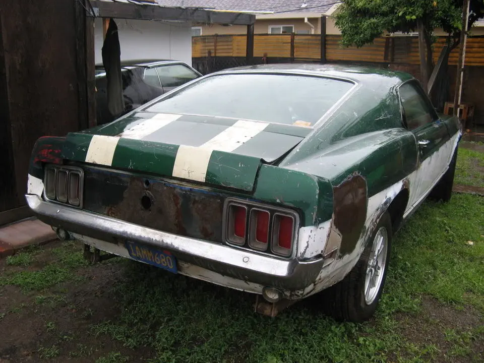

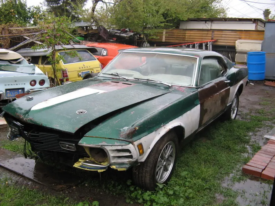

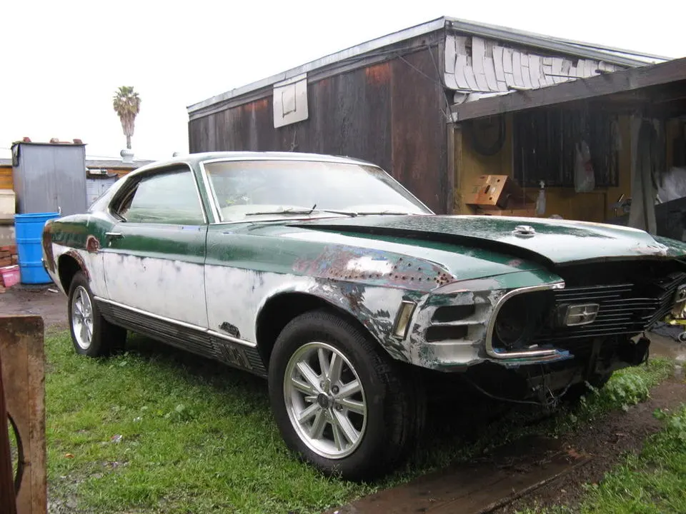

Ouch, I dont see a single piece of that body that isn't in need of quite a bit of work. Hope you like sanding!
Whatever, it looks good. If you're scared of a little sanding go put more lotion on your hands and pay someone else to do your dirty work.
Hit the car with a coat of primer to get everything one color and have fun with it. The car looks straight, looks like a good find.
I'd use a different master. Steve recomends a 1" unit off of something that is dirt cheap at $90 brand new. I'd buy all your suspension parts from OT. I think that's the least of your worries.
The bodywork ahead on that car, frankly, scares me. From here I can tell you you're gonna need two quarters and a tail light pannel, and probablly a core support in front.
If it were me, I'd rotissire that bad boy right up front so you knew what you had. Bag it, tag it, blast it, and fix it up as you can afford it.
On a positive note, it IS a Mach 1 so that's a plus.

I didn't say I am afraid to sand (I have had two jobs doing just that) but if he restores those body panels, the car will be more patch and bondo than original metal. I would probably replace the majority of the sheet metal and push those dents in the roof out do avoid as much bondo as possible.
I have never liked the chopped top classic mustangs, why would somebody do that? It is a ton of work and leaves no head room for the passenger/ driver.

Low Budget? Look at the bright side, it doesn't need wheels. A good car starts with a solid foundation. There is no mention of the body and chassis repair in you post which is puzzling as this car obviously requires it's fair share. Have you looked underneath the car? If you are not capable of doing this work, hiring it out is gonna blow up the budget. A good guess would be your looking at 10-20K for rust repair, panel replacement, body work and paint. The parts you list are probably another 10K and the under hood expenses surely will run at least another 5K. Figure an additional 5K for everything you forgot and what you haven't found. Any way you slice it your looking at some dough to dance with this one. Is it worth it? Absolutely! But be realistic and know what you are getting into before you start.
Dont know how much bodywork you guys do but thats nothing I would shy away from. I think its a GREAT starter car that will take a LOT of love. The amount of money he wants to save is up to his mechanical ability and tool availability.

passenger 1/4 panel (just the skin, not a whole 1/4)...to bad you are not in tx, I just gave away a full 1/4 cut off an old rusted up car, but it was a great 1/4
pound out the dents in the roof
front passenger fender already has some work
the doors line up GREAT
headlights buckets could be replaced..the tabs are gone and they are a bit bent up
the core support doesnt look bent
I think its great. It just looks really rough because of the paint. Lots of sanding (I would have it blasted or dipped) but a solid start.
My shave and a haircut paint job is going to cost me $5K in bodywork, $1K in paint labor, $1K in materials plus all the parts that got replaced which I'd guess I'm about $4K deep about now. And I got a deal. It wasn't supposed to wind up this way, but they always do.
This car is worse than mine ever was.
