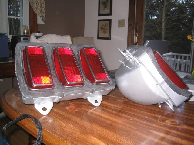

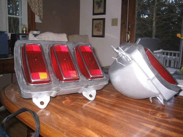

However, since I could not have rebuilt my busted tail light without all those extra sets you gave me when we first met to pick up cobrask8 #1 (so many parts not available repro still) I'll put this one up now just for you! Aren't you proud I am going budget as much as possible? The only parts I purchased for these were all the new gaskets!
