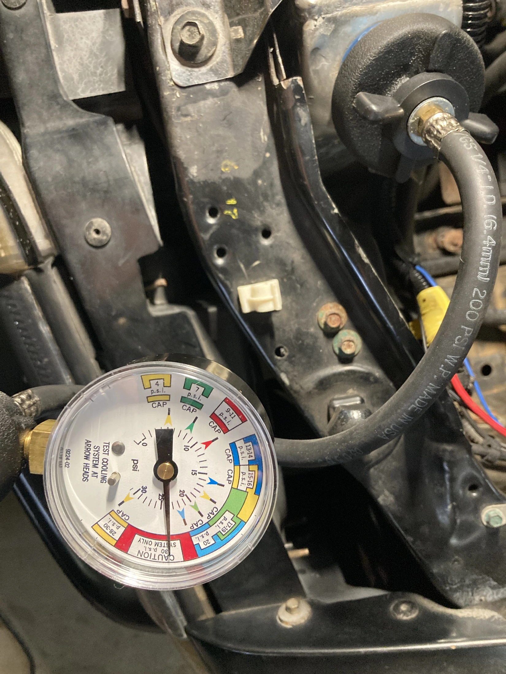

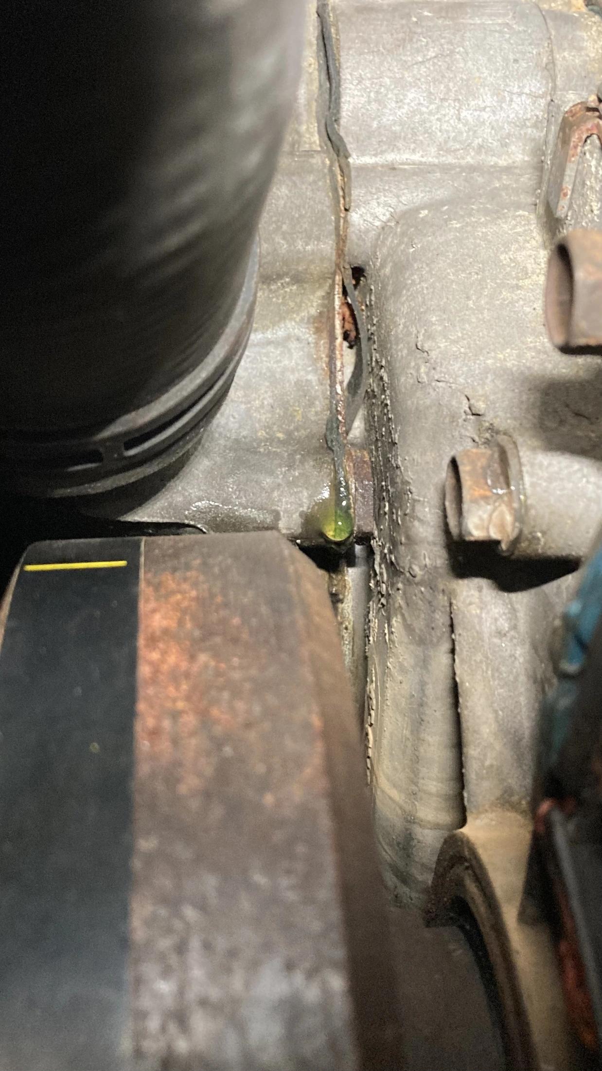

Resting with a cool engine I pressure tested the cooling system. Although it has a minor leak from the water pump gasket, it held close to 30psi for 45 minutes before I released the pressure.
