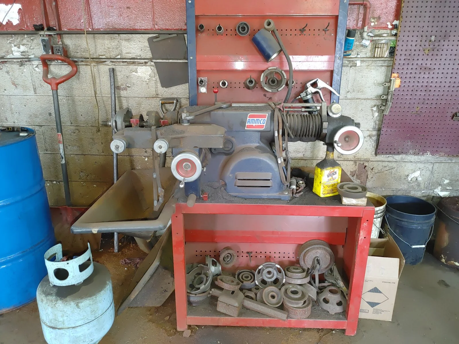

@74stang2togo If I had a ProCut at this shop I would be turning these all day long and on the car to boot I think my mechanic would try and kiss me. BUT I have this lathe that is older than I am. This thing will take 30 minutes a rotor and is a demon to find parts for.

I hate the old slow single speed lathes. Hunter 10 speed or a ProCut on-car or nothing. Can't make money cutting rotors (at the technician level, anyway) with a machine that slow.
