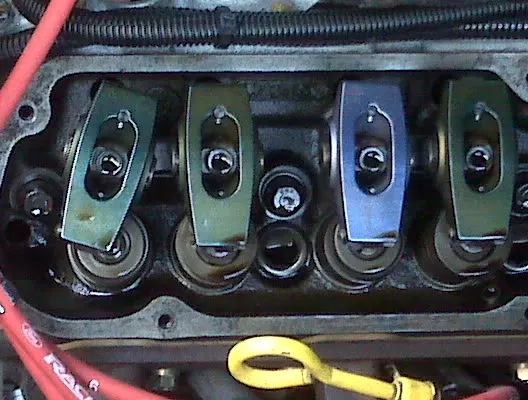

power shifted into 3rd lost the shifter due to a sweaty palm and a POS stock shift knob. looks like im going back to my steeda knob or getting a pistol grip set up

your lucky thats all that broke.............
actually didnt break anything... i pulled it off last night and nothing wrong with it... just came loose

lucky. You don't run a rev limiter? My 6AL saved my butt many times

i would be willing to bet that the valve came in contact with the pistion if your rocker came off like that, did you roll the pushrods on a flat surface to see if they were bent?
yep... didnt see any problems with them

if you dont have a chip there is no way that the car should have revved to 7000

6al box has saved me too but if youre basing 7k off the stock tach reading then odds are you were really hitting 6250 for a long time and stuff started coming loose.

It's my understanding that 5 speed cars have the limiter set at 6500, while the AOD cars only go to ~6200 from the factory. So if you miss a shift, it can wind out a little bit, but it shouldn't be going to 7K.
