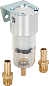

I would reinstall your PCV valve and filler neck to throttle body hose. You have no way of eliminating harmful corrosive crankcase vapors right now with your changes. If you are worried about oil consumption, put a PCV Oil-Air separator
in line between your PCV valve and the upper intake manifold, that will collect some of the oil that will naturally travel along with the crankcase gases. Also, your PCV valve requires a little mesh filter

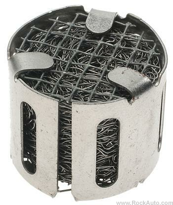

underneath it in that hole in the lower intake to keep excessive amounts of oil from traveling through the pcv and into the upper intake. Many people lose these/throw them away, and then wonder why their motor is taking in so much oil.
