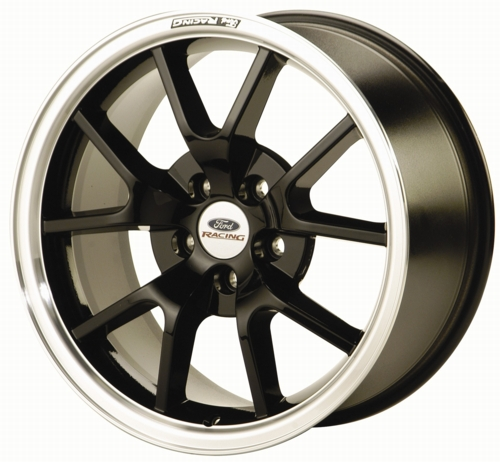

thanks for the info. how much did your brakes cost you. I think the kit should cost around $2k. and i will be running 18" wheels.
these are what i want
on a all black notch :drool: :hail2:
