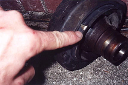

there are so many things that could casue vibration, I wouldn't replace the balancer unless it looks bad. The stock balancers can separate where the center rubber isolator is..I've attached a pic of mine from when it went bad for your reference...
