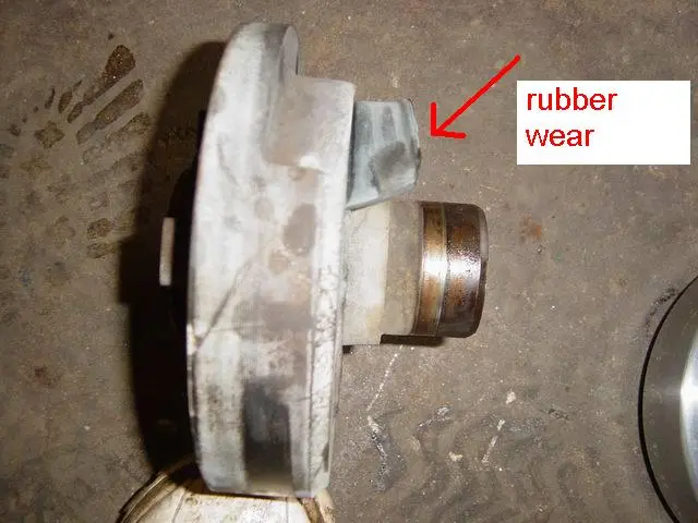

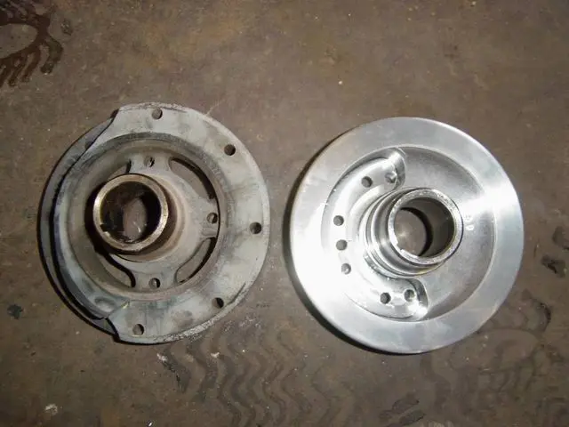

9 94stang-lover New Member Jan 18, 2004 62 0 0 Jun 8, 2004 #4 Jun 8, 2004 #4 the rubber on the stock balancer always go bad specially if u rev ur car close to 6000 rpm. i already change it twice and finally went with a sfi one. check the photos Attachments 1.webp 22.1 KB · Views: 151 2.webp 30.3 KB · Views: 161
