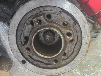

any ideas what brand or weight? I purchased a 347 stroker from the seller who didnt have any info... tried looking for markings on balancer and couldnt find any... any ideas?
I'd say older power bond by the design and snap ring, seeing backside of it will tell you the balance but if its a legit 347 probably 28oz
Most 347 kits are actually neutral balance, and have been for some time. The 28oz imbalance 347 kit was like a 90s thing. But yeah, you just have to look at the back of the balancer and see if it has more weight on one side in particular.
