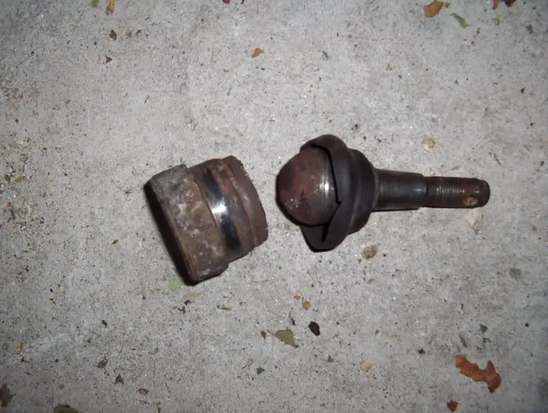

do your ball joinmt before this happens, i had to change mine in a parking lot :notnice:
