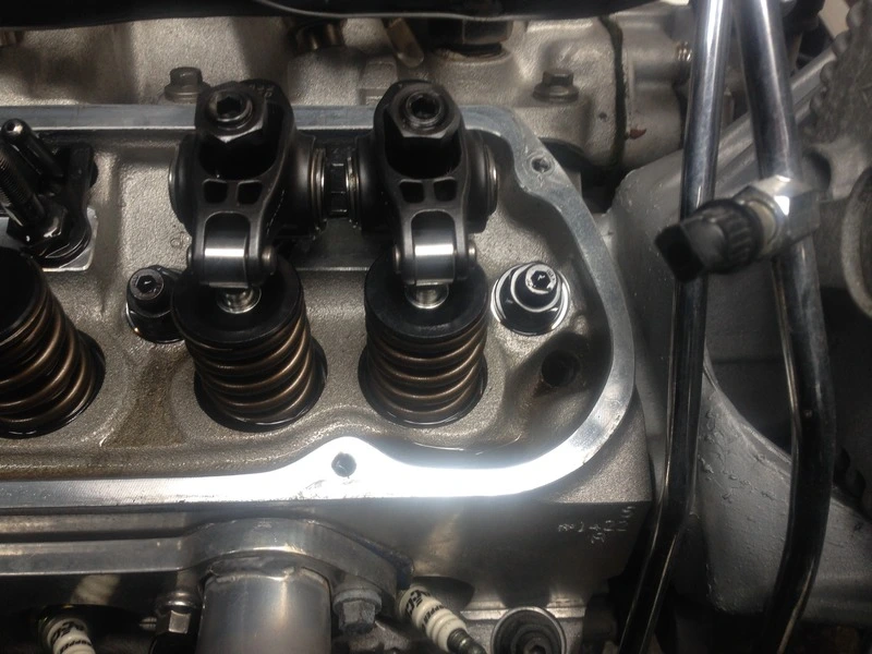

RangerJoe said:
Are you sure those are ARP studs? The AFR's are notorious for breaking their stock 3/8" studs.
This exactly, although 3/8 studs will be more than fine for a 500 hp build that will see less than 6500rpms IMHO

yup its the stock afr studs,so you think its over kill to get 7/16?....should i just put in arp studs in and call it a day?...
thanks guys

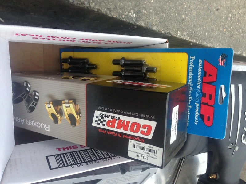

parts are here...hope i can get this right!

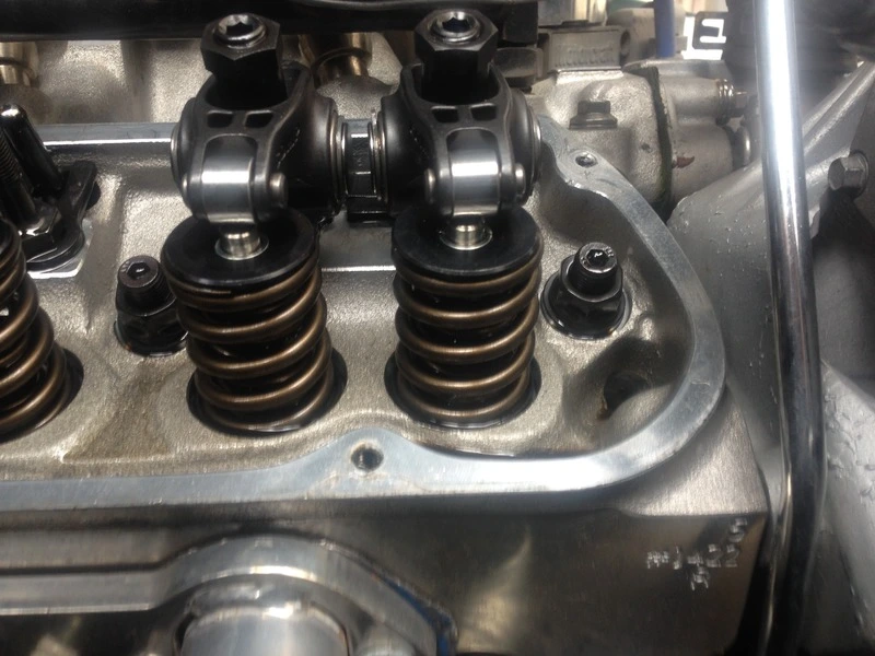

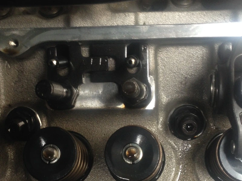

ok so i started and then stopped....these heads have the adjustable rocker stud plates,i was trying to align them the best i can but it keeps moving when i try to torque the studs?...so got it the best i can and held it with a flat head but they dont seem to alighn very well?...i tightend the rockers 1/2 passed 0 lash....
any tips guys?...the ones that are still on there seem the same way also?

this is how the engine builder has them,kinda all over the place also?...you guys tell me?

Nice choice on the rockers! Are you using a little moly lube underneath the base of the stud? That should help it turn a little bit. If I remember correctly, I had to adjust mine all a little differently. Also, I was advised to use thread sealant on the studs that are open into the ports (intake I think).

That rocker on the right looks out of alignment. I'd be afraid of causing undue stress on the spring and getting coil bind or breaking it. Use the moly trick listed above under the studs to tighten them to spec w/o binding the brackets/guide plates.
