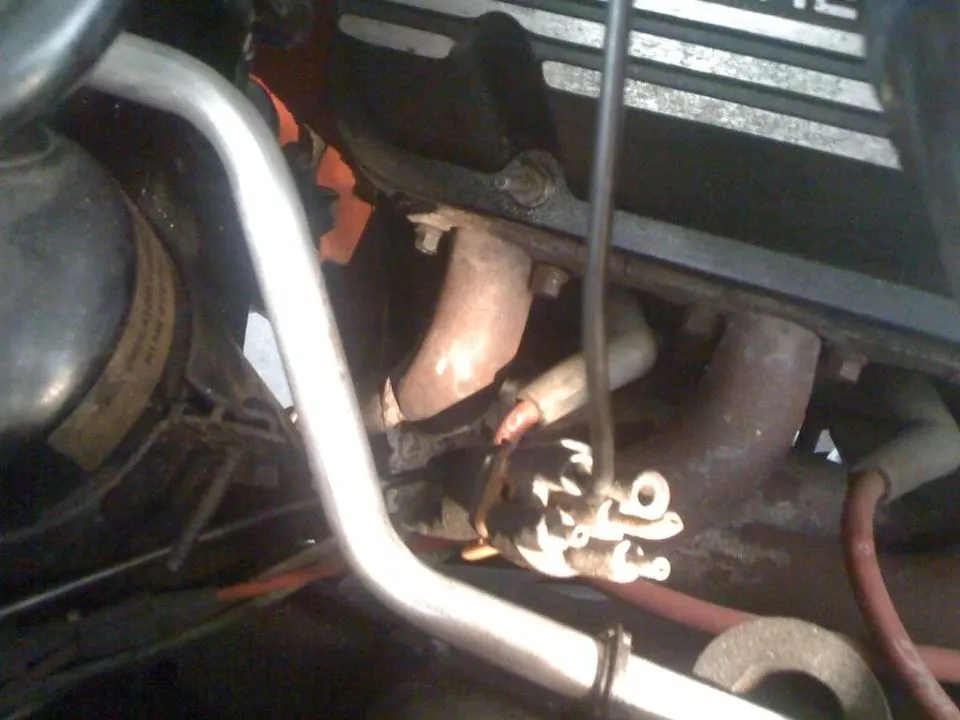

No my EGR Valve vacuum line goes to the 4 way block connector but does not route to the EGR Regulator Solenoid.
This is a pic of my EGR Valve Vac Line (Black Line going into connector). The Black Line coming out from the bottom isn't connected to anything. It's not even going to the right hole in the connector. Which hole does it mate to? The one with the Green or Red Line from the bottom?

The vacuum line from the EGR valve goes to the opposing green line. You should have another vacuum line coming from the backside of the upper intake to the opposing red line.
