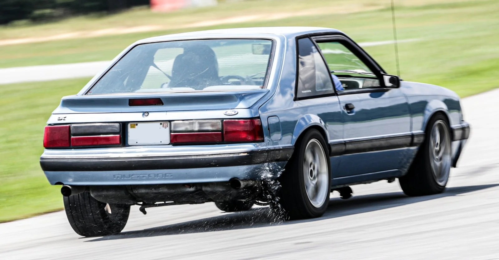

So, I took the car to the track for the first time a couple of weekends ago. I quickly learned that, in hard left-handers, the gas cap wasn't up to snuff for holding back the gas slosh. It even managed to do it on a mostly empty tank. I checked afterwards, and my filler neck grommets seem to be in good condition. The gas only seemed to be leaking from inside the fuel door not from the bottom of the filler neck, as you can clearly see in the picture. When screwing the cap on, it feels tight and there isn't much play to it. After pitting multiple times and quadruple checking it, I know the cap was on as tight as it could be.
The most peculiar part, though, is that pressure would manage to build up inside the tank and I had to vent it through the gas cap. I'm aware that the gas tank vent needs to be addressed, but this means that the gas cap is sealing tight enough to keep the fumes in. I'm genuinely stumped as to where so much gas is coming from.
I'm posting this to ask what I can do about it. I looked around online and didn't get any clear answers. I feel like just getting another gas cap online would just result in the same problem unless my cap is missing some sort of seal that I'm unaware of. Any info would be greatly appreciated.

and what is that hanging down on the right side of the pic under the car?
if that is a open header pipe then expect to be a fire ball upon exiting a turn if this issue is not corrected

I'm very well aware of the danger, which is why I'm trying to correct this before the next meet. Though, I would imagine the open header would have been more benificial because then my tailpipe and exhaust near the spill itself was not hot.

As you can see in the picture, I was running a dump pipe out the underside of the car, which I think bought me some time for heating up the tank, but as I mentioned before, after a few laps, it was a problem again.

I did see you were dumping the exhaust out the side. Sorry, I was just trying to reinforce that once you get your venting issue fixed you hopefully won't have much trouble since you are dumping out the side already.
