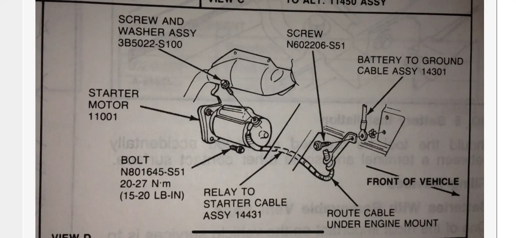

The battery cable, from the starter to the relay, has a bracket on it about halfway that bolts to the engine somewhere.....
does anyone know where it bolts to??? Thanks
83 5 liter manual......

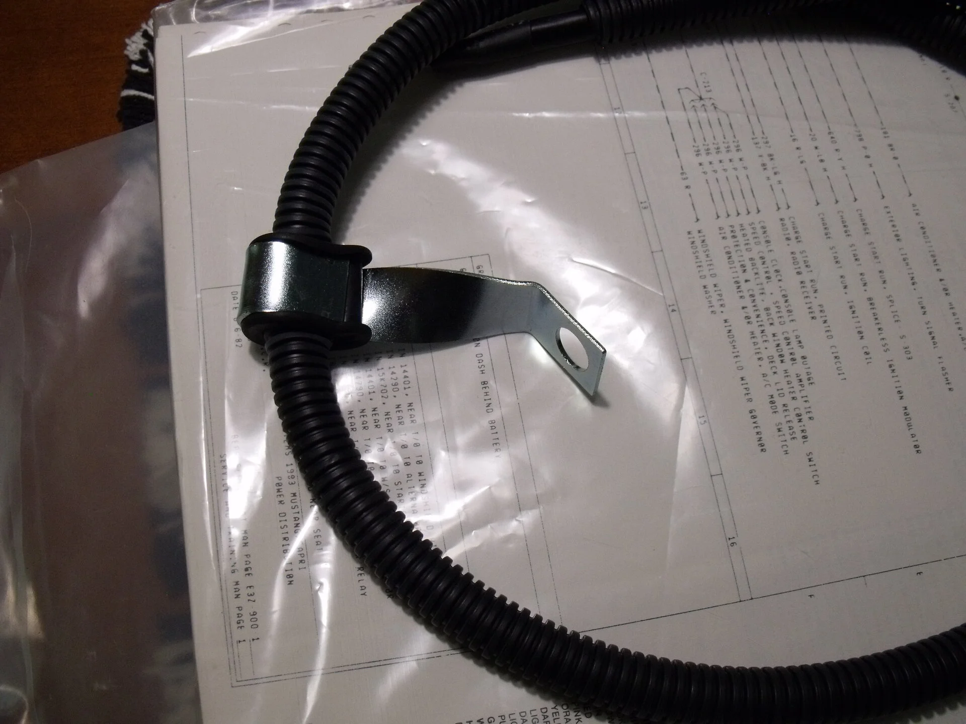

Here is a picture of it.. Only one... No diagrams in my Ford service manual for placement...

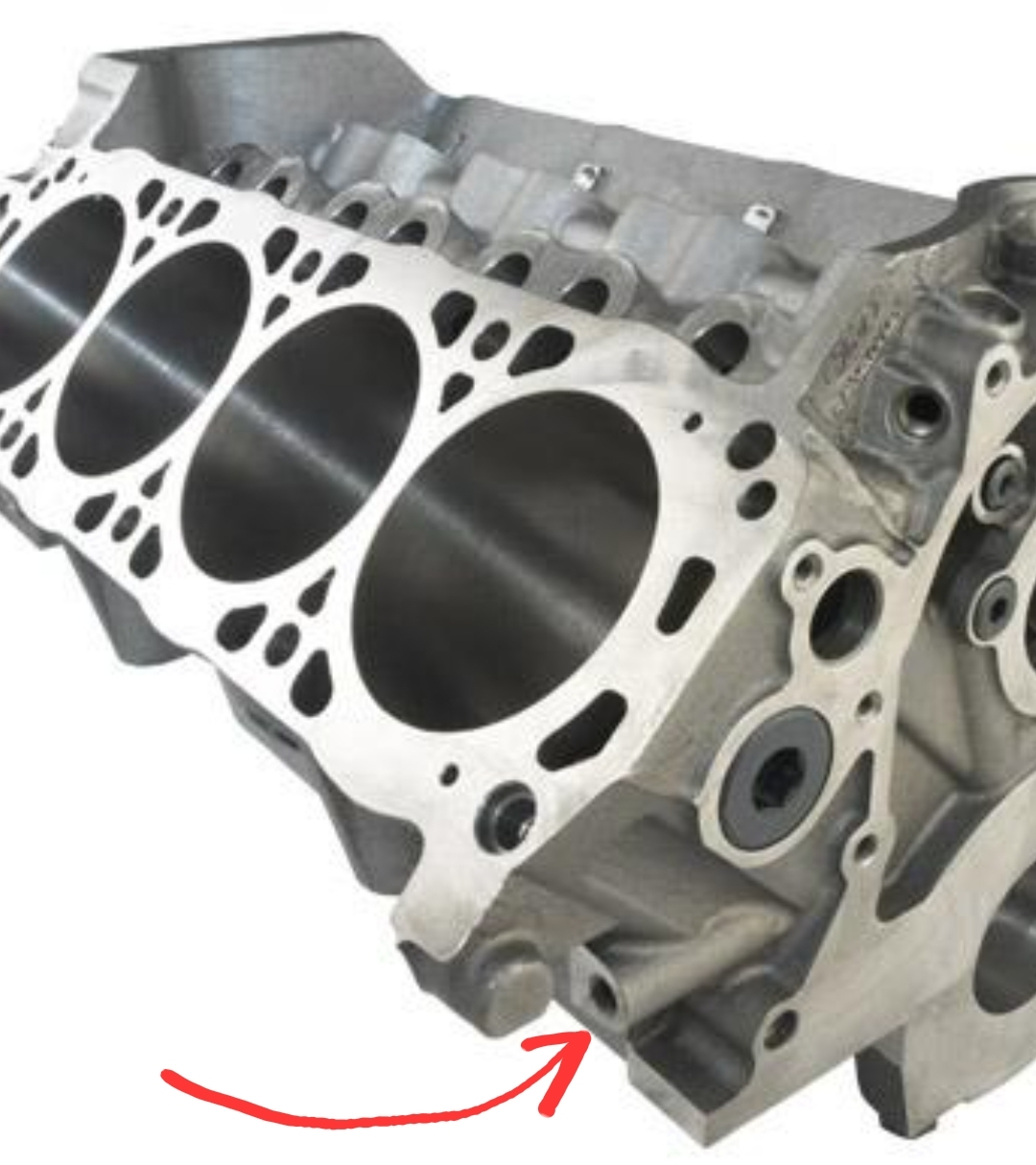

Thanks for the pic........Yes that helps, but what is that hole its bolted to?? Must be where the motor mount bolts to the engine?? Trying to install all that I can on the engine before I put it in the car.... Looks like I need to get the Ground cable also and install it at the same time...
