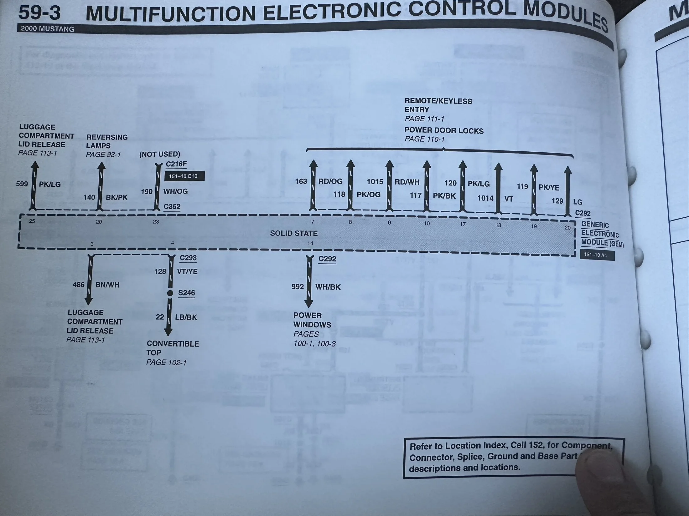

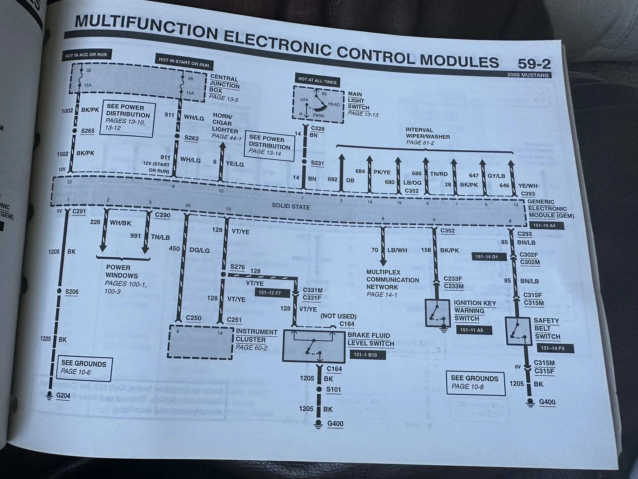

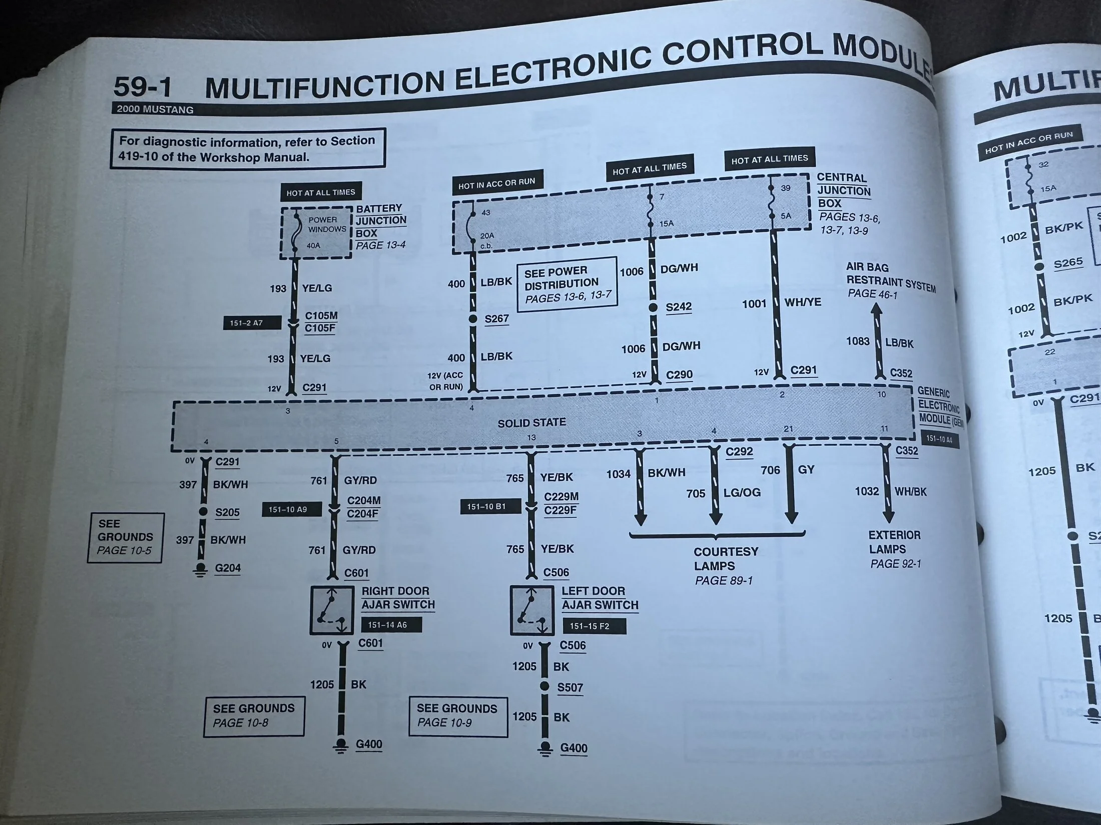

Some reference wiring diagrams here

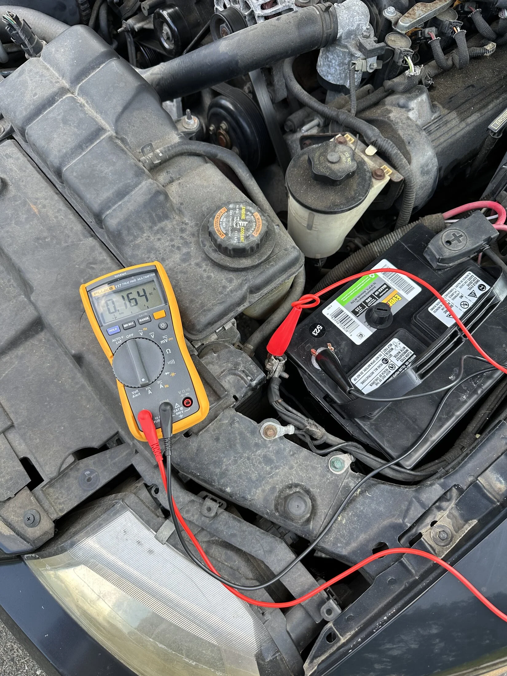

0.35 amps drops to 0.16 amps when I unplug the drivers side mach amp. No change on pass amp.
GEM standby is about 120 milliamps, which is .12 amps. It should drop to 35 milliamps after 40 min.
So my next step is to rig my meter up to stay connected for 40 mins until the GeM goes to standby. Should be about 0.035

Thank you for this. Do you know what systems each plug controls on the GEM? I was thinking about disconnecting one at a time to see if I could narrow my searches to a specific system. Or maybe even see if I should change the whole module itself.
The systems are listed in post #2.

Thank you. Maybe I am not understanding post #2 correctly, but are those what the GEM module itself controls? I was thinking about disconnecting each harness from the GEM itself and seeing which plug stops the drain. And from there see what that plug specifically controls.
Yes, the GEM controls pretty much all the interior components that do not have to do with the engine management. So while the fuse points to the GEM, it doesn't necessarily mean the GEM is the culprit. Could be a failing door latch or interior light bulb shorted.

That's where I am right now. I unplugged one of my Mach 460 amps and the draw went from 0.35A to 0.16A. So i'm about where you are. I need to rig up my meter tonight to let it sit for 45min and see if it drops down to 0.050A or less.

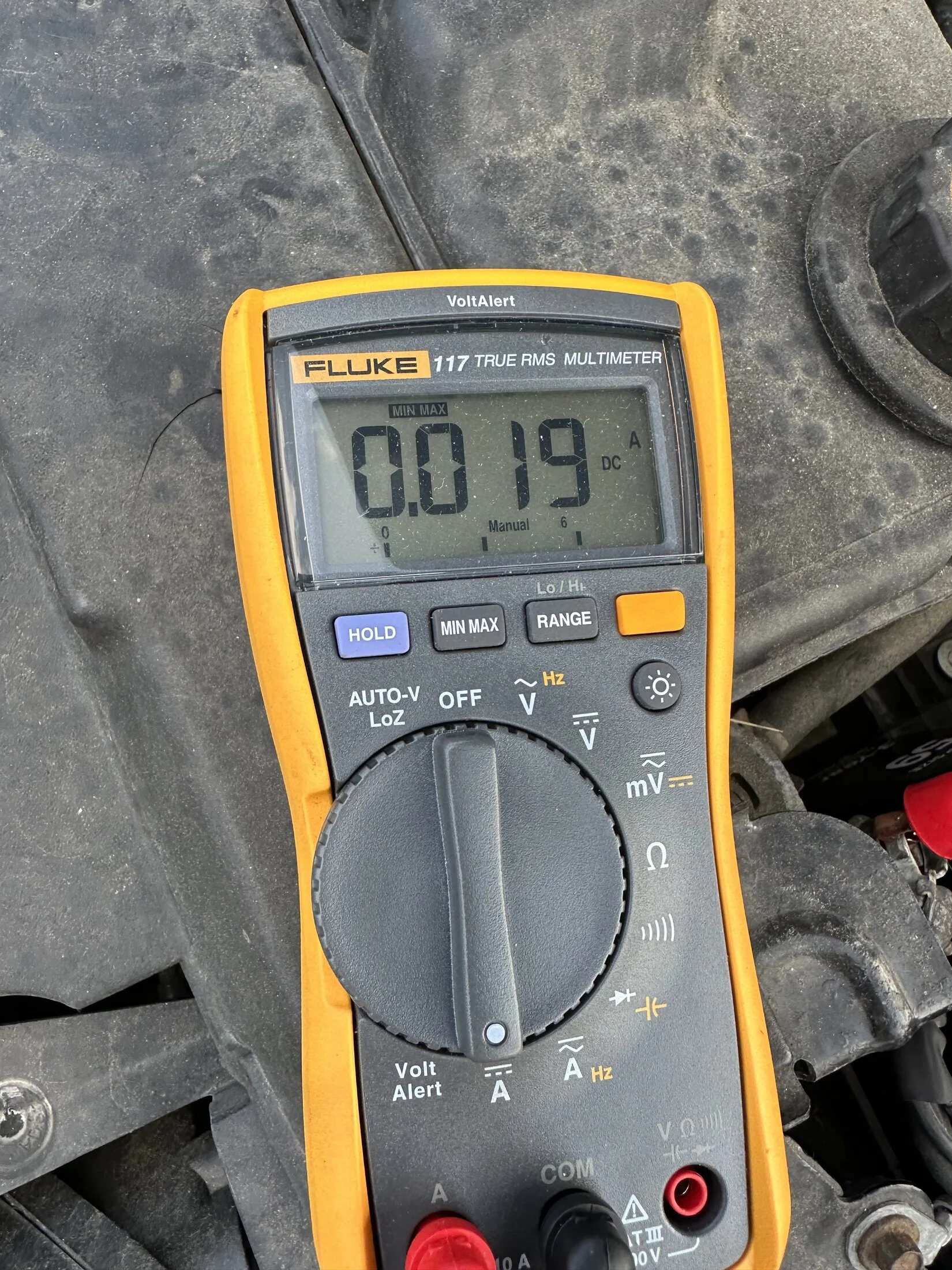

In my case, the source of the draw was the radio/amp. Both my head unit and one rear amp was bad.
0.16 amps when I start.
After about 35-40 min, the GeM goes to standby and draw is 0.019 amps (19 milliamps)
As suspected. GEM just needed time to go to standby.

These are all the things that tie into the GEM.
You’ll just need to go down the list and unplug various items and see if the GEM goes to sleep. Sounds like it’s not

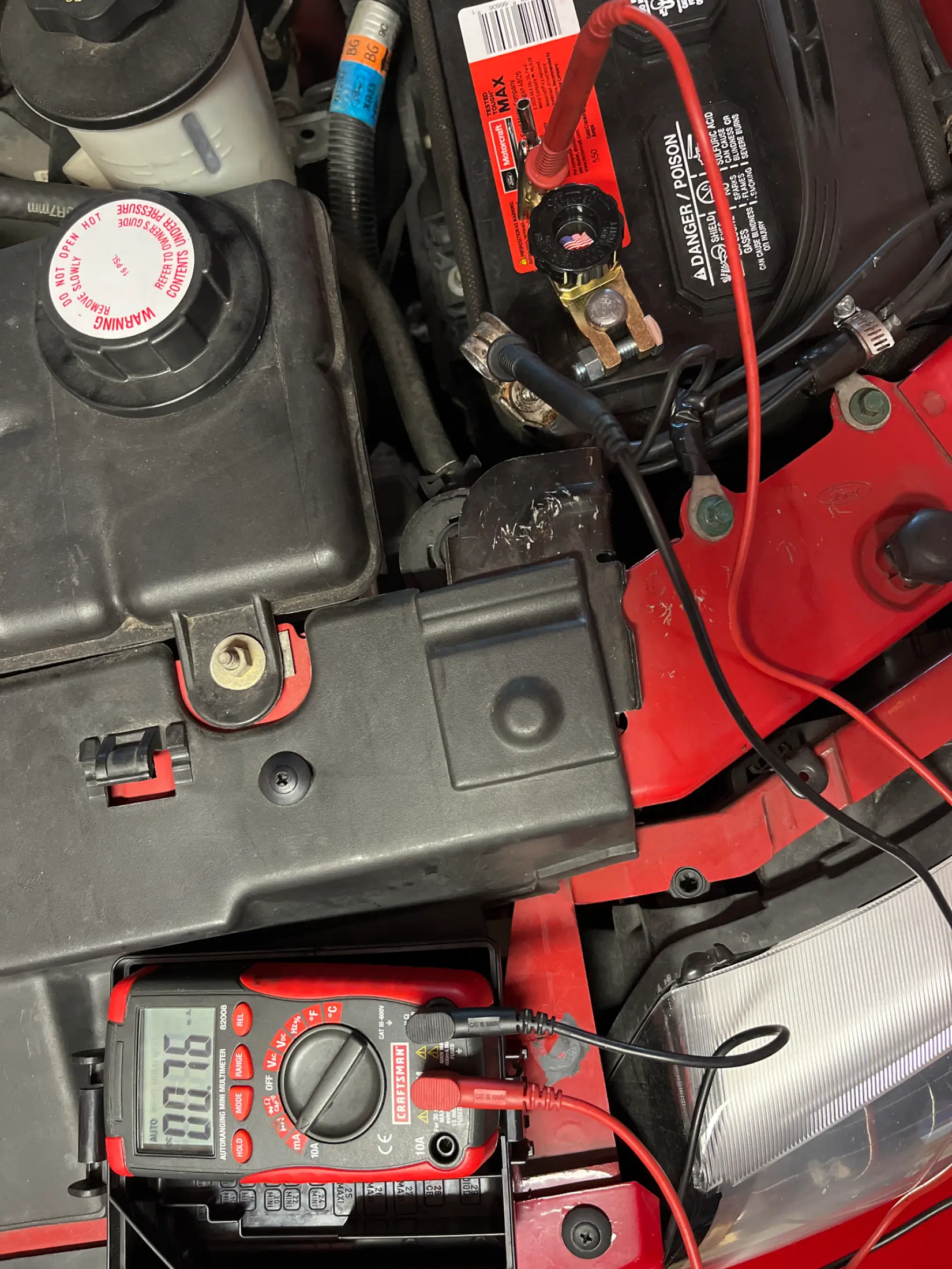

Going to try and revive this thread here, as I’ve tried to follow this post to the letter and cannot confirm if I am doing this correctly. On my 1999 GT Convertible with Mach 460 amps, I get a dead battery every few days. First I disconnected the negative battery terminal and hooked my meter (mA DC) between the battery post and the terminal. Initial reading is ~0.76mA. Doors closed and locked, roof down. Disconnected both rear amps, no change. Removed the 40A Maxi (No. 6 under the hood, as No. 6 under the dash is for the starter relay according to my owners manual), no change. Currently waiting for the 40minute timer to go off, but these numbers aren’t close to what the rest of the thread is saying is the general readings for the GEM (before or after going to sleep). Am I missing something? New to this so trying to learn, any help is appreciated!
Edit: Waited an hour or so before I started pulling fuses. Consistently around 0.76mA.

I’m second guessing the meter now that you bring it up. It’s definitely not new so should probably replace it or at least get a second one to verify. With luck I’ll be able to get to the store to get a new one today after work and try it out.
