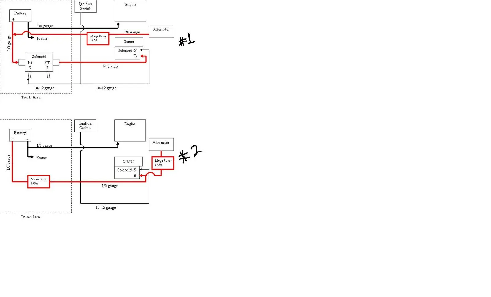

I have seen many ways to relocate the battery to the trunk. some r good, some r bad and some r out right dangerous. I have couple if ideas on how to relocate the battery and hopefully will not have a nuclear melt down under my A$$ in case of an accident. I wanted to get somebody's opinion on it. Thank u
