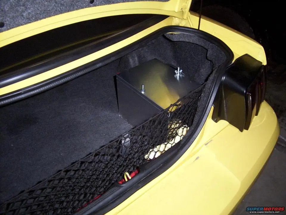

Mines not centered but here it is. Taylor box with Summit Racing 2ga cable kit still using the factory battery.

There is no generic placement for a track car. Put your car on corner scales and put the battery and box in the trunk and move it to see where it should be.
It's usually towards the passenger side to offset the driver's weight unless it's a rally car where you have a co-pilot then it's more towards the middle.

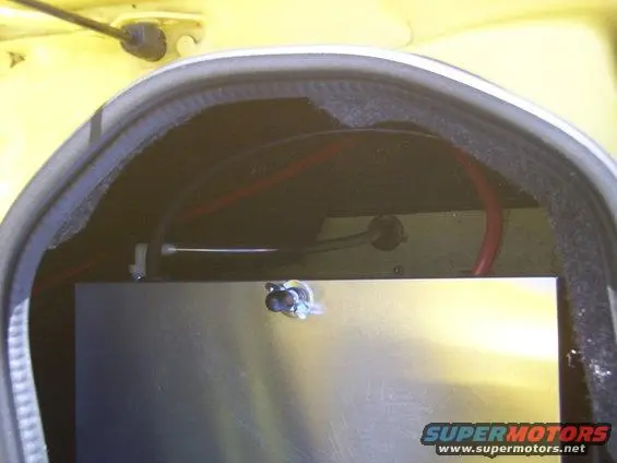

jeffnoel - where's the air duct?
Also you have to remember (if you want perfection) that gas is a moving mass and it will effect the heavier side in the rear even if it's counteracting weight in the front.
