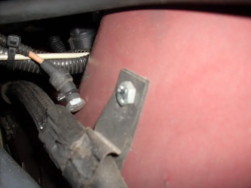

Long tubes do the same thing. There should be a little clip that holds the line to the inner fender. Go up inside fender behind the strut and drill a little hole a little higher up. Then detach that clip, and pull the line up and attach it at the higher hole. It is flexible enough that you can strech it by hand. You will have to use a small bolt and nut to attach it to the new hole. I've done the same thing on all the SNs I've put headers in.

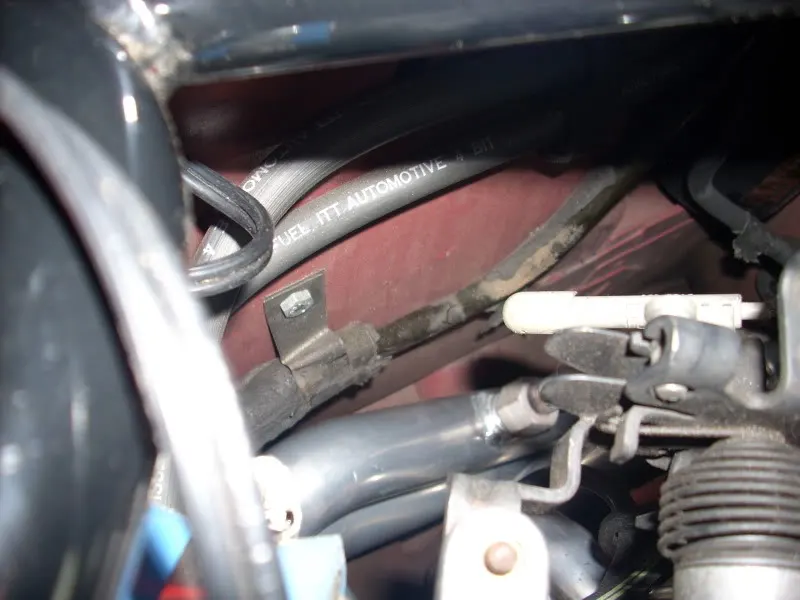

When I put my BBK longtubes on, it melted the AC line. I actually redesigned the routing for the line, and had a hose shop make me a new one to my specs. It's not necesary though, it's really easy to relocate the stock line. I'm having an issue with BBK right now, because they sent me the wrong EGR tube, but their headers definately are better fitting. They offer 1 3/4 primary headers for SNs now, they just don't have an EGR provision. I actually have the car where I just bent the stock line back in here for more work right now, so I decided to post pictures of the relocation. You get the general idea from the pics, but it's not easy to get a camera in there.

new '94 cobra owner with this EXACT issue! I'll try moving the line this week - so, just drill a mounting hole a bit higher up the shock tower, correct?
One question, though....the stock lines are routed to keep stress off the connections - will pulling the line up create stress on the connectors enough to cause a freon leak? Also - would a tubing bender help to bend the hard lines slightly to help in the line relocation? Or not necessary?
No, there's no issue with it causing a leak. Once you get in there and feel how easy that hose moves, then it will be more apparent how little stress you are putting on it. The car in the picture there has been like that for 3 years now.
