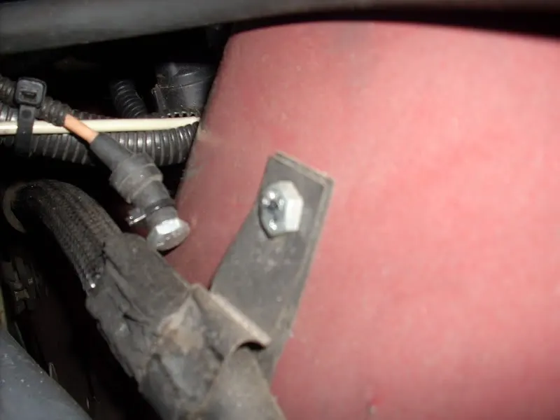

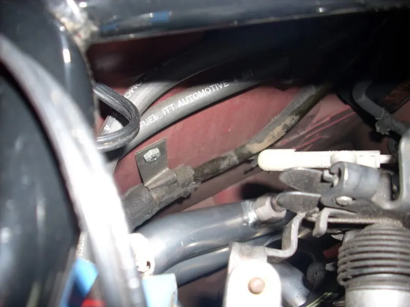

Don't forget to relocate the AC line on the passenger side if you still have AC. If you don't relocate it, it will melt. I have posted pictures and information on how to do this in another thread.

Where can I find that post on relocating the A/C line? I looked at mine under-hood and I see exactly what you mean; it's located right across from the exhaust manifold. My '95 has a bunch of heat sleeve over it from the factory, but even with the shorty headers there's only about an inch of clearance.

Ok, it's actually really easy. On the high pressure AC line that runs along the passenger inner fender, there is a little bracket that attaches it to the fender. You want to remove the passenger side wheel, and drill a hole through the inner fender about 3 inches higher than the original mount point for that bracket. Reach inside and pull the line up, and attach the bracket at the new point with a small nut and bolt. These pictures aren't that great, but it's kind of hard to get a camera in there. This is on a 94' Cobra with BBK longtubes.

WOW! The long tubes stretch a lot further away from the heads than the shorties. This really illustrates the importance of moving that AC line.
