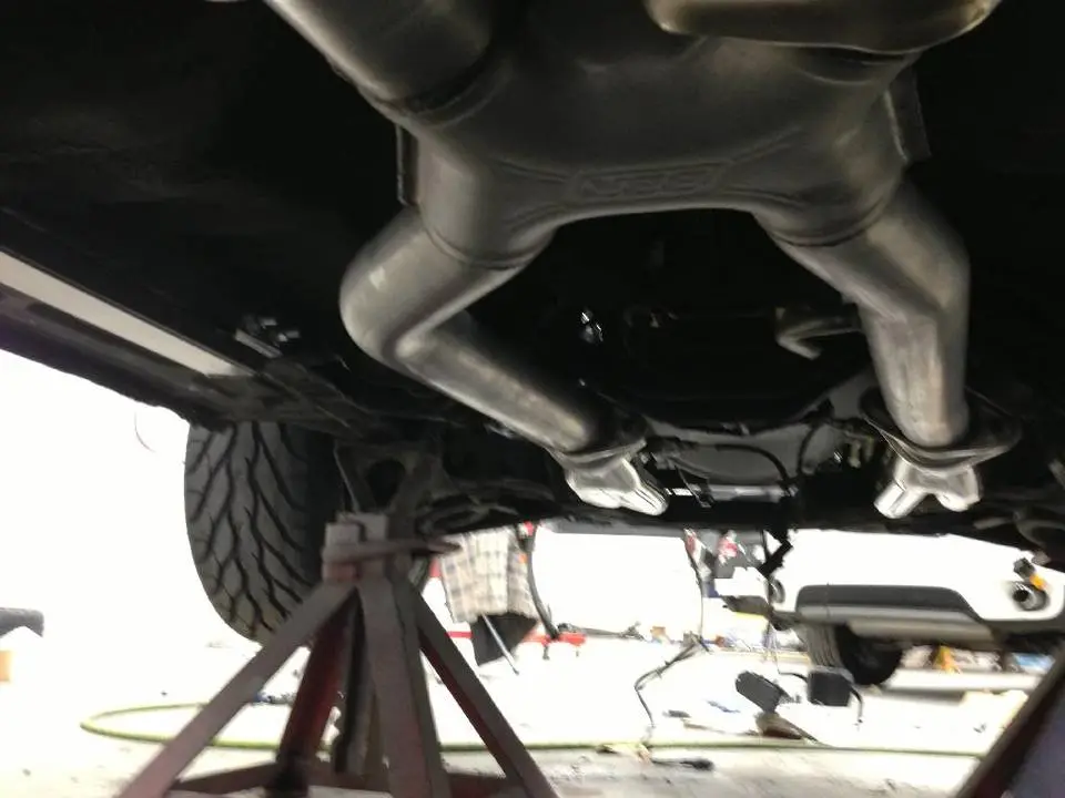

manual,my tranny is on its way,my car is in storage for a few more weeks,and even though i installed them,i realy cant remember, so i was wondering the same thing...im going to install the tranny soon so ill find out,from what i remember i think i may have too?,but judging by the one pic i have,might be able to wiggle it out also...?...not much help....lol
