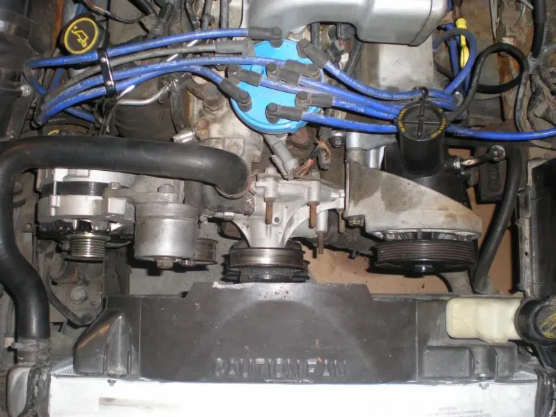

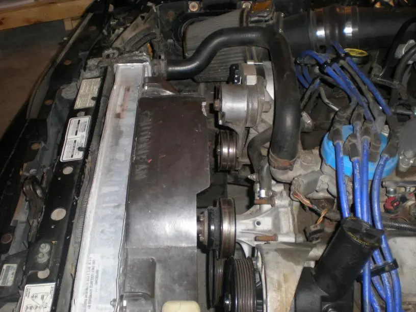

The problem is the P/S pump actually sits somewhere between the old ac and original spot for the P/S. The angle across the tensioner to the P/S pump brings the belt too close together it will rub and not work. I have it routed just as the red belt shows and the tensioner just buries it on top of the water pump pulley. I am hoping the underdrive pulleys will fix it somehow by having different pulley sizes.

DO you have the Ford Racing A/C delete kit that moves the P/S pump up?
That's the exact setup I have, with the smog pump deleted. I have my belt run like the red belt above and ther are no clearance issues at all.
Maybe you have something different i am not seeing. Got pics? :shrug:
I do have the bracket. The 72.5 is really close, if I put it on there is maybe 1/2-1/4 inch between tensioner and W/P pulley. If I put any pressure on the tensioner it will rub I. This is why I am hoping the bigger pulley for the Alternator from the underdrive pulley kit will change the angle enough to fix it. I know alot of guys run this setup, thats why its so agrivating.
