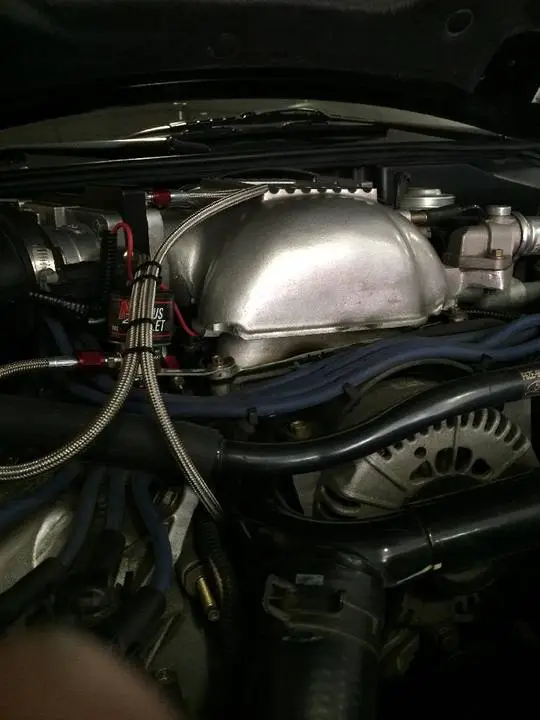

Fuel puddling while on the dyno before the first spray.Whooooooooooooa.
Musta been a good size bang. Cause?
Not likely...........fuel puddling will cause the system to be rich. The only way you get a nitrous backfire is if the nitrous is activated at too low of a rpm. If the engine died while on the dyno, or was shut off, and then it was started while the nitrous was active, then you would get a nitrous back fire. The nitrous system should never be activated below 2,500 rpm or you are just asking for trouble.Fuel puddling while on the dyno before the first spray.
