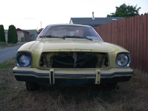

i don't know the answer to your question. but i would like to know more about your 1976 mach 1. are you sure that is what it is? do you have a picture?
Yea, Im pretty sure it is a Mach 1, I ran the numbers at MustangII.net and it returned that it is a #'s matching Mach 1. The picture I have isn't too great, but here it is. I dont know if you can tell from the pictures, but keep in mind its stripped to go on a rotisserie.
