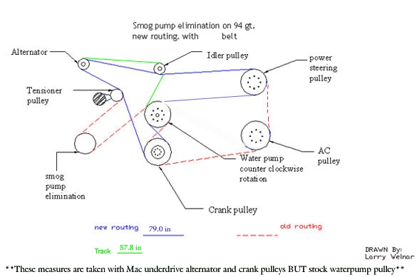

I've got a '95 GT... The Smog pump is shot on my car, i mean SHOT, it sounds like ASS! anyways, I don't need the Smog pump to get an inspection sticker, so i'm just going to chunk the thing, i know how to reroute the belt, thats not a problem, BUT i don't know what size belt to run when exempting the Smog pump, can anyone help me?
Also, the AC doesn't work, I don't feel like fixing it, and the Mustang is not my daily driver, it's my toy, so i'm just going to get rid of the AC also, is it possible to delete both the AC and the Smog pump without running delete pulleys, or if i wanted to get rid of them both, i can run the Smog pump with a rerouted belt, and buy JUST the AC delete pulley? what are your takes on this? do you know what size belt i need? There's no point in arguing the removal of both items, as the car gets driven MAYBE 30 miles in a month. and when the Baby gets here, it'll be even less than that. can anyone help me?

here is the absolute best belt/pullie diagram I have ever seen.

1TallMF said:
attachment.php
+1 :nice:
That diagram answers alot of questions on this forum, nice find!
I agree, I sent it to my house (as i'm at work now) to keep for future reference, and also printed it to add to my binder of '94-'95 Specific Info i've acquired throughout the years... Now i just gotta put the pulleys on, and get the new belt... WOOHOO... It shows me the answer to both of my questions, I can delete the Smog pump, AND AC at the same time...:nice:

I was searching for a belt that only bypasses the A/C unit as the diagram does not have this.
I believe it was mootang or hissin (maybe somone else sorry), but they found this A/C bypass belt to be 91.5 in length. Again it may be alittle off but is deff. in the ballpark as a great starting point.

I ran just A/C delete and ran a 93.0" belt with unknown brand underdrive pulleys.
I also tried bypassing the smog pump, and had problems. The problem is that the tensioner cannot work correctly without the smog pump. If you look at the diagram, when the smog pump is bypassed, the belt is almost straight between the alt and crank. The tensioner just deflects it a little. This creates only a small variation in belt length, as opposed to the stock routing, in which the tensioner has a much larger effect on belt length. When trying to find the right length belt for smog delete, I tried a belt (don't remember the size) and it was too short and really hard just to get on, then a belt that was only 1/2" longer was too long. The tensioner just cannot work properly given the changed geometry. It can't take up as much slack as it should and was designed to. I gave up on smog delete and just used the smog pump as an 'idler pulley' and enjoyed the properly working tensioner. IIRC, the smog pump only uses a tiny bit of HP anyway, and that was cheaper than a smog pump dummy pulley.

I had a buddy back home that ran a re-routed belt a week or so after he got the car to delete the Smog pump, he had a '95, and is the original owner, so it's possible... as for the reason i'm doing it, isn't because i want the HP gain, it's because the bearing was shot, and it was making a horrific metal on metal grinding. as for deleting the AC, my AC has been shot since i got the car back to Norfolk from Baltimore, so instead of spending the money to fix an AC i'm not going to use,seeing as the car is a toy,and not a daily driver. so i re-routed the belt, fit pretty snug and i know it'll loosen a bit. as for the belt, in order to re-route it, minus the AC, and the smog pump, you need a 82" belt. as for my car, i'm looking into gears, and a DSS 306, Long tubes, X pipe and trying to decide on what muffler, along with a set of 31 Spline axles, and a TKO 500.
