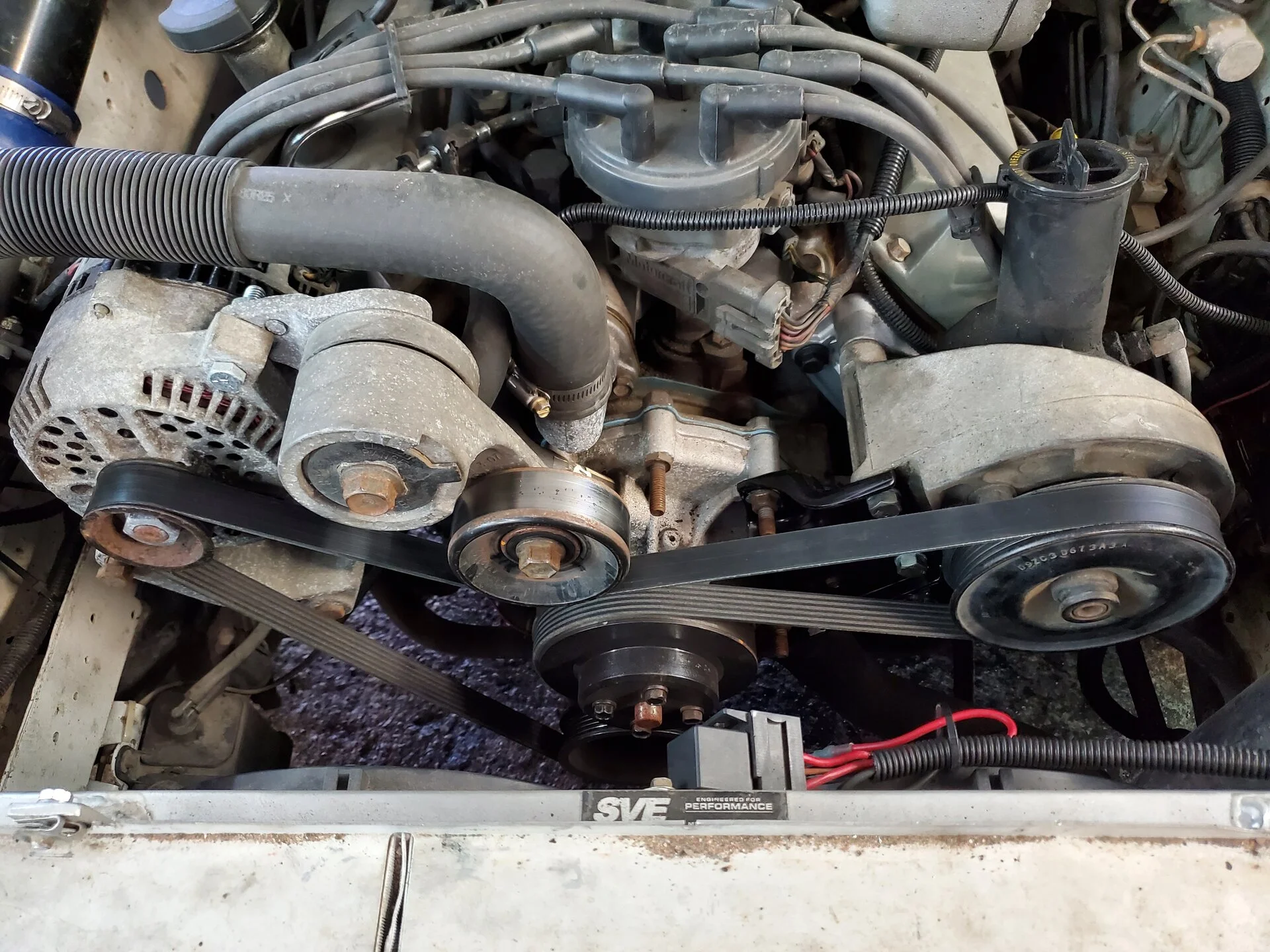

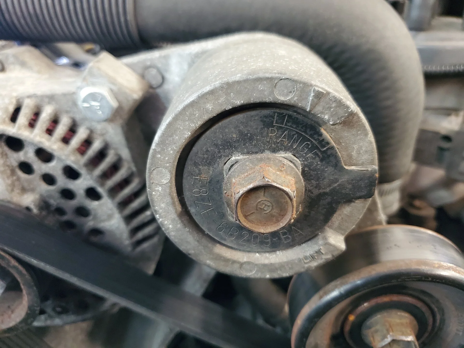

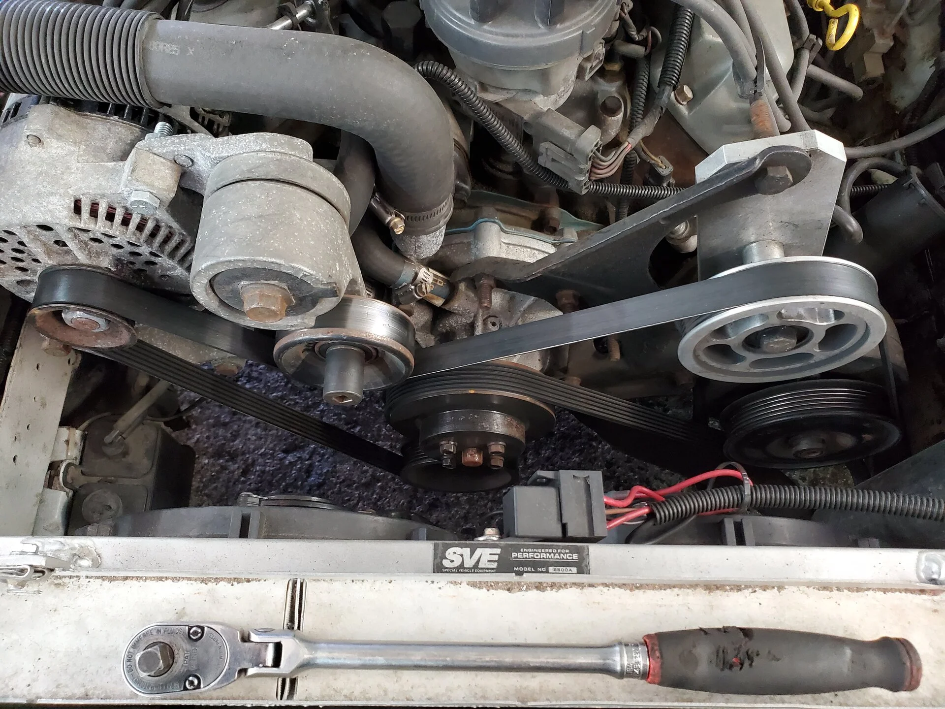

Finally installed sve power steering relocate brackets. Easy install and got rid of the noisy ac delete pulley. Took a few tries figuring out belt length so wanted to post what worked for me. Smog bypass. Sve ps relocate underdrive pulleys and 3g alternator. I needed a 72 inch belt.
