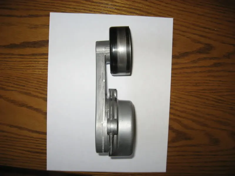

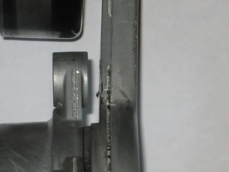

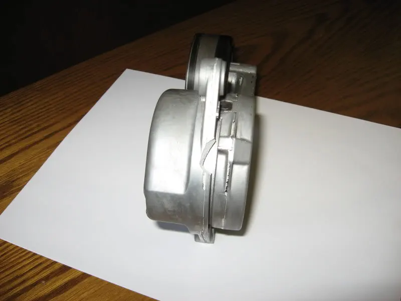

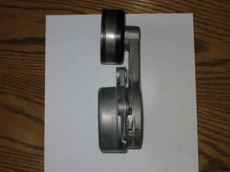

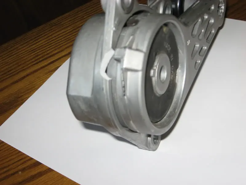

OK, here's the results. I ordered the Ford Tensioner, got the car up and ready to be torn apart and then took the tensioner off. Needless to say I didn't have to go any further to find the problem. Here's the results. look how bent that piece of crap is.
The bolt bosses on the aftermarket tensioner were too thick and as the tensioner would move it would catch or hold up, it snapped the bump stop piece that is supposed to keep the tensioner from flexing to far right off. Needless to say the Ford piece is way better quality. Thanks for the help Randy!
