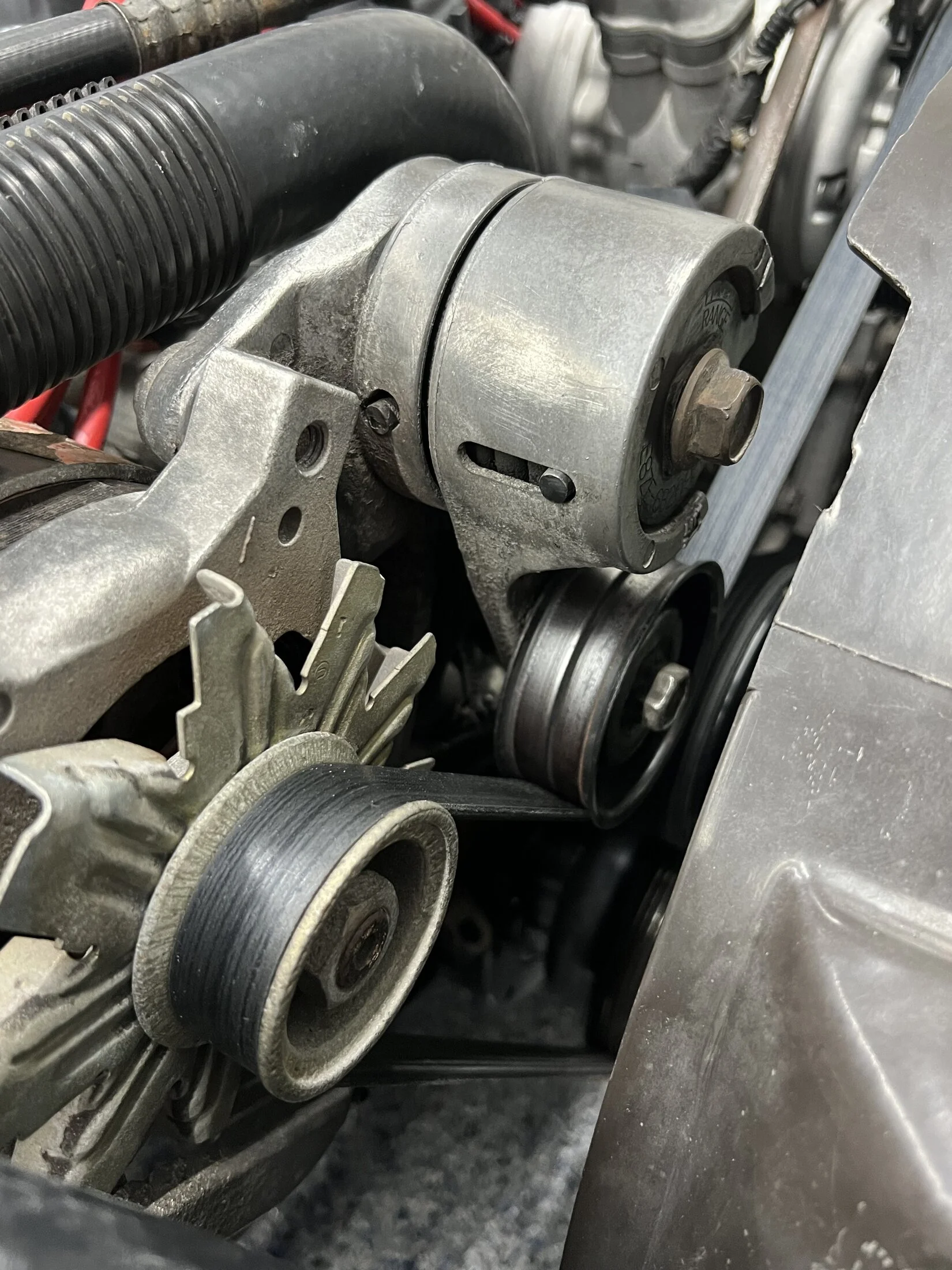

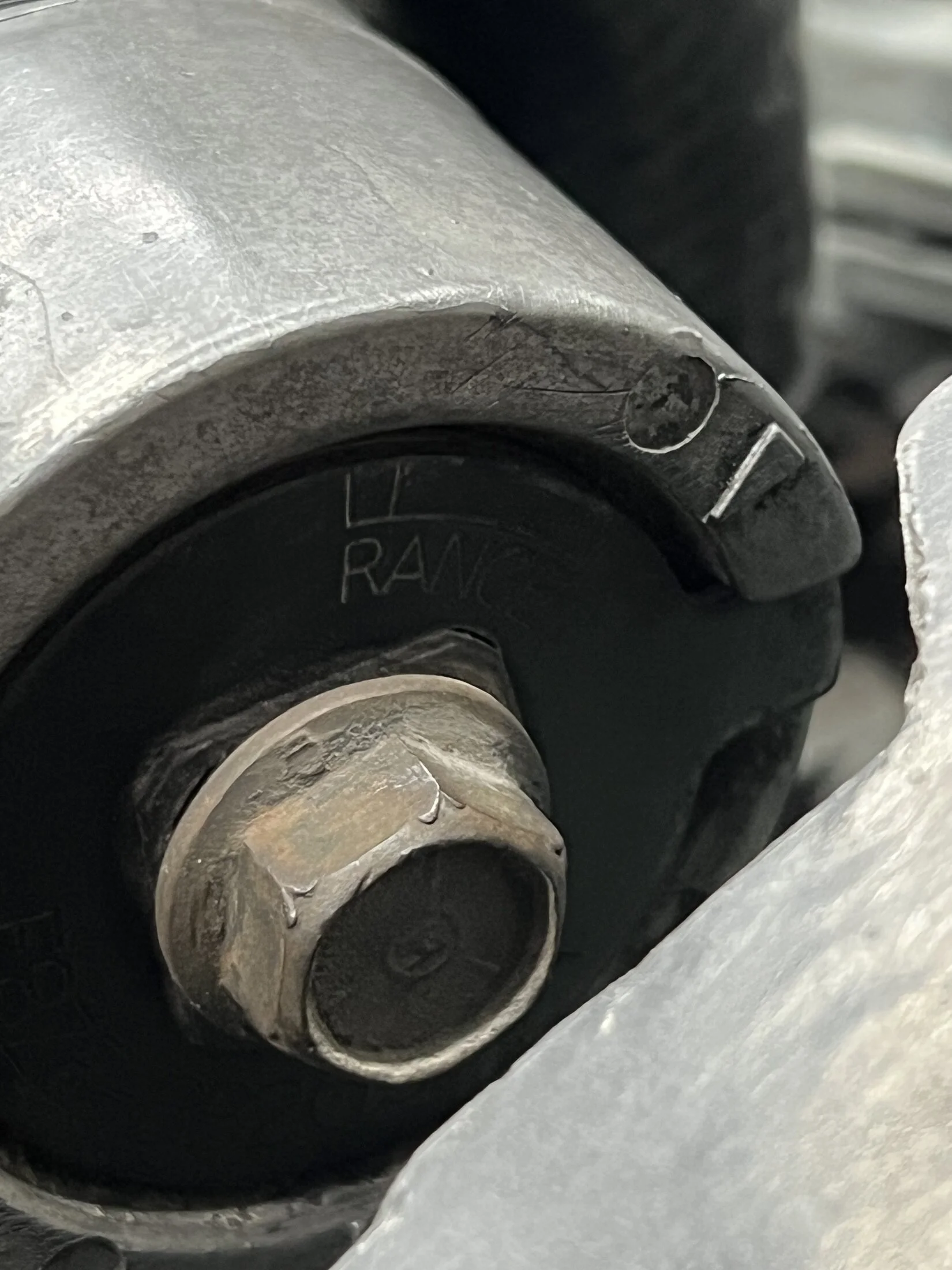

Just changed my harmonic balancer and now that I got it all back together and running again I get a tapping noise from the engine. My buddy that was helping me lifted it up pretty far when we were putting the belt on so I suspected it didn’t go down all the way. I put a breaker bar on it and sure enough I was able to push it down a good amount and the tapping went away and all was good. I thought that was the end of it but when I drove it around the block now as I was driving it started tapping again and when I got home I lowered the tensioner again and the noise went away. I just want to clarify with you guys that that makes sense and a bad tensioner would cause that clicking noise. Also which of the ones on rock auto would you recommend. The Gates brand?
Yea now that I’m looking at it this belt is definitely too long. I’m gonna have to find a shorter one. This was the one on lmr made for smog delete cars so idk why it’s too big but who knows.

Yea, turns out the one I have which lmr sells is really a 85.25 when they have it advertised as a 84.5. What I’m wondering is if a 3/4 inch difference will bring that tensioner back to the correct setting. What do you guys think

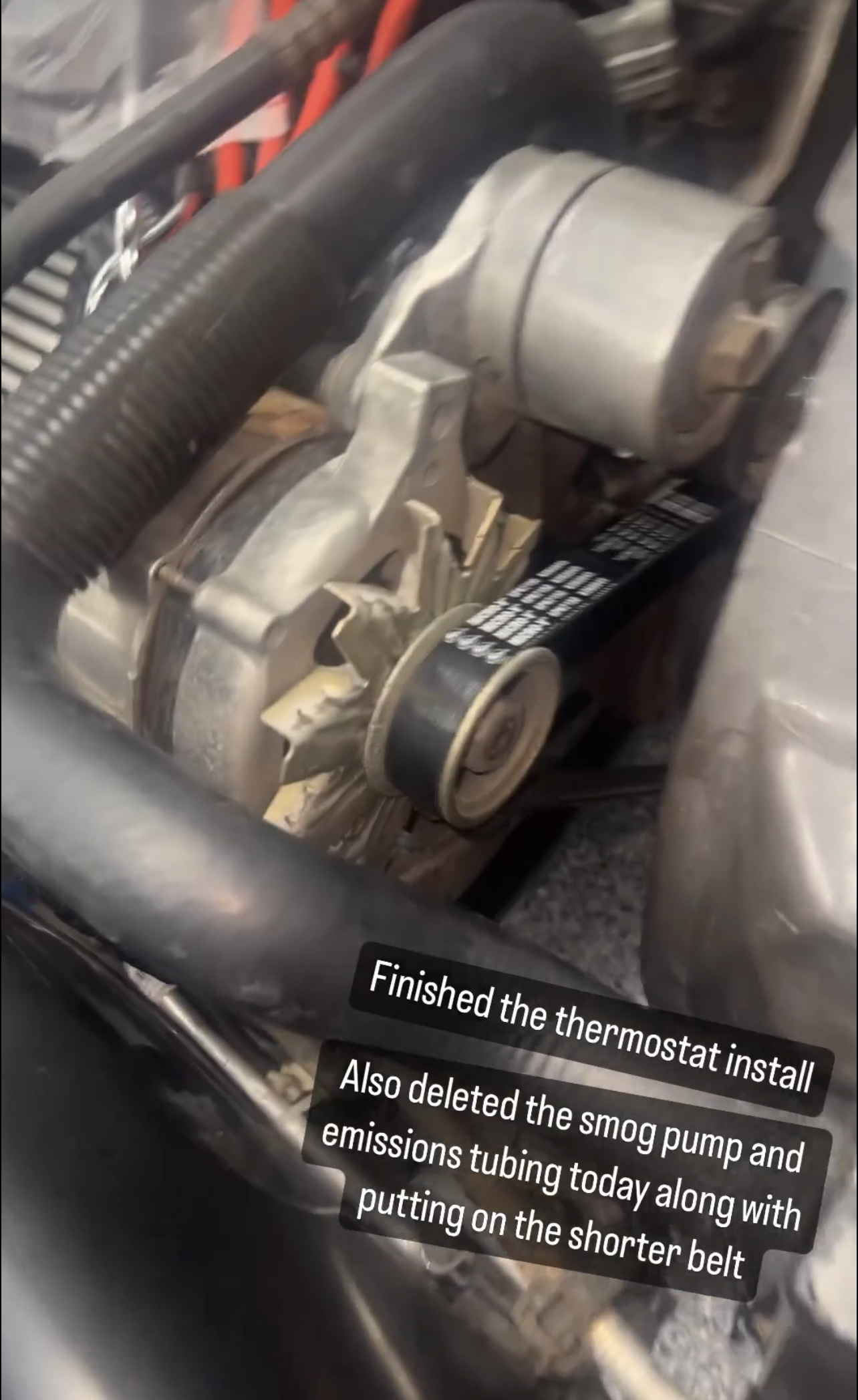

Found this pic from when I first put the smog delete belt. The tensioner was not as low as it is now. Then after I did my balancer about a week later and put it all back together it now sits straight down?? Doesn’t make any sense to me. I ordered the tensioner and the belt hopefully just the belt does it and I can return the tensioner

These belts stretch, so I always pick a belt that puts the tensioner in the tight end of the range and over time it slowly moves to the other end. When it goes out of range (or it just looks bad) I replace.
Your original tensioner is probably close to maxed out. They do move a little while the engine is running so it was probably internally maxing out which was the tapping you heard. A shorter belt to move it more into the middle of the range would probably have fixed the issue.

When I did my 130amp alternator upgrade, the pulley was a hair bigger than the original. Belt would not go back. I got one 1/2” bigger and it went right on. I thought for sure I would have needed more…… so to answer the question….. that 3/4” may make all the difference you need.
Put the new belt on and its got the tensioner sitting perfect now. The tensioner no longer clicks however there was another tapping noise going on now. Turns out now my fan is hitting the shroud on the part where there’s a hole on the shroud going in towards the fan just above the radiator. I replaced the fan too so I’m guessing this new dorman fan is slightly different and it has some clearance issues with my sve radiator? I bent up my radiator hold downs to get it tighter and just to be safe I’m going to file that piece in the shroud down.
