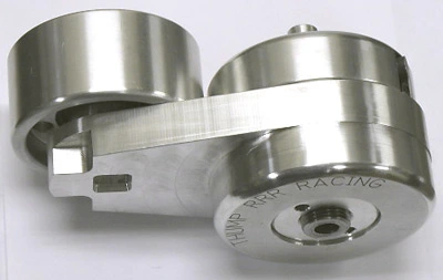

Thump RRR Racing now is selling a billet version that fits your car...I have the 3 bolt version for mine and now have no belt slippage...
I also did change the pulley size to a larger one, since they are relatively universal, and it helped add tension by changing the position of the tensioner arm...
