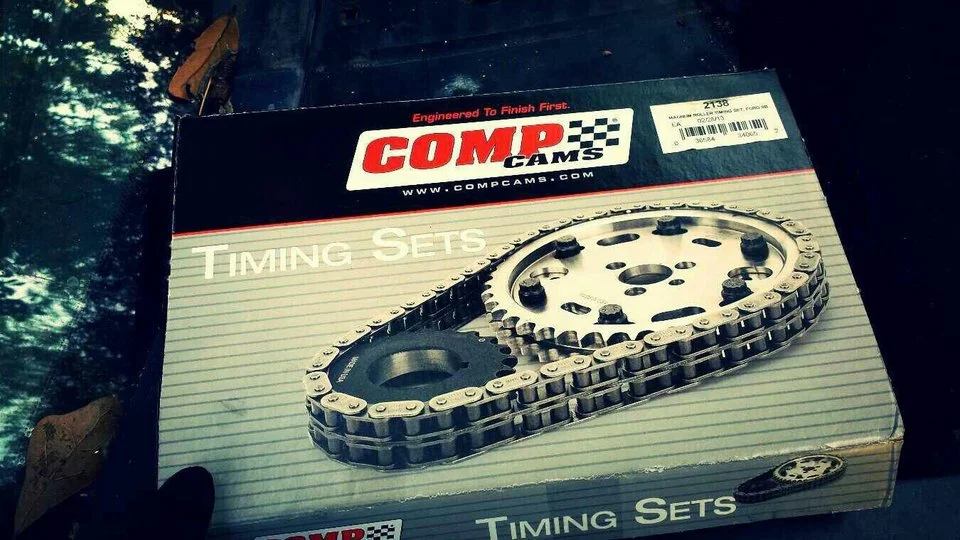

Brand new Comp Cams Double Roller Chain and Sprockets
Same thing I got,
