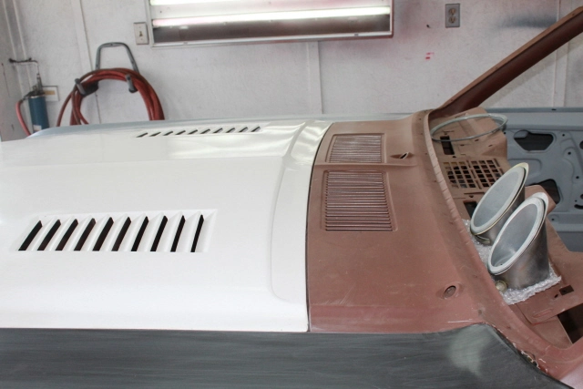

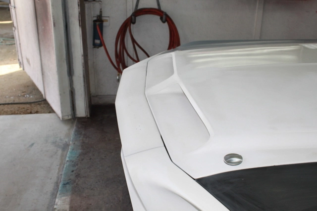

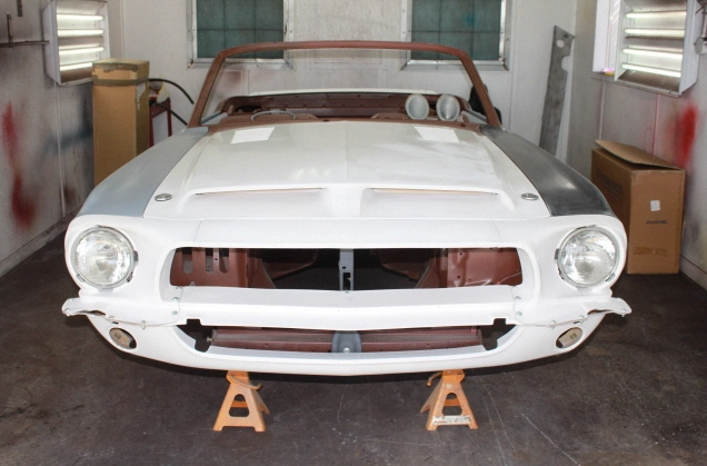

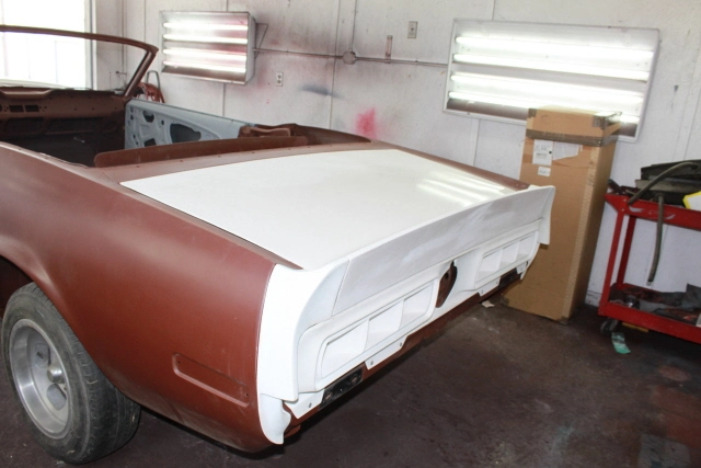

the underbracing it was so soft, again cheep materials, miars i had to pie cut the trunk lid in several places to get the arc right and the gaps were about a 1/2". i started using stang- aholics a few years ago and am quite happy with them. i know they use iso ressins and not ortho resin ortho being the worst you can use,it starts to deteriorate almost emediatly. fiber glass is not like fitting metal it does take a little work to get it perfect if you are expecting perfection from fiber glass then i would suggest going a different rout, i will post a couple pics of my 68 there is no body work done to any thing but i did have to sand flanges for a flat fit and fit properly . the glass is form stang-aholics
