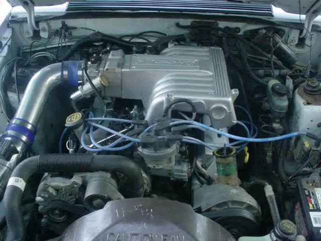

here is a pic..
the air filter is mounted in the fender, not in the engine compartment

Yeah the stocker with no silencer and a K&N is a great option if you are just running bolt-ons etc. Power diff between a stocker and a CAI is very minimal, but if you really do want a nice CAI that will work well and look good go for a MAC or BBK or any other brand that mounts your filter in the fenderwell instead of the engine bay. Good Luck
