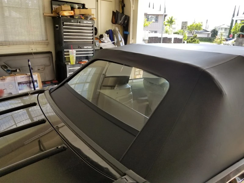

I have done 3 in the last few years. For me the Electron brand fit the best.
This top on the car below is about 7 years old now. Still looks good.

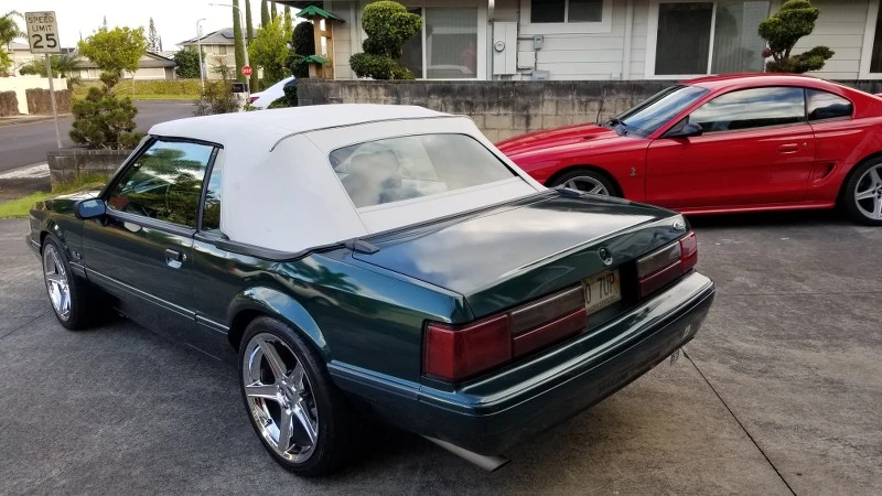

The Ez-on top has marks already on the back side of the top. They are usually pretty close to where they need to be. I've used Ez-on tops many many times.
The one I did had marks on several places , and it made it work out very well. Without them I would have had bigger problems, It had holes all around the bottom of the window piece that aligned with the screws around the rear deck. I just plugged them in with small adjustments.
In those pics you'll notice in 92 they got rid of the top rib and staples above the back window. That strip isn't really necessary. The window staples to the bow below it. Sometimes you can lower the top and remove and restaple the window there to tighten it up. Too tight and eventually the vinyl will seperate from the rear glass ( on a weathered top...not brand new ). Another adjustment is to remove some of the shims ( washers ) from behind the bottom tack strip below the glass. This will pull the window further to the rear and can help with wrinkles there too. The only other option is to tighten it up with cycles of heat and cold water. This isn't for the faint of heart because it can make the fabric brittle or burn it if not done right.
