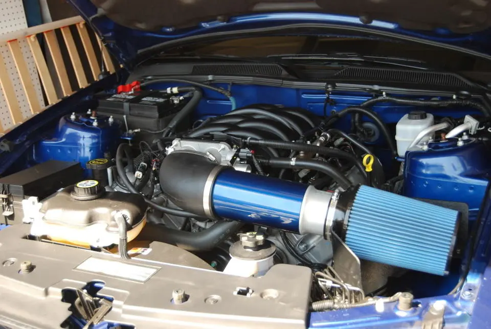

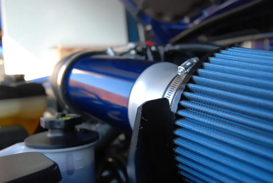

JLT is the best CAI for mustangs, just do research. Everyone will tell you what they think or what they have is the best. Do the research and it will show that JLT will give you the most horsepower. It does require a tune, but you might as well do it right the first time. When I first got my mustang I didnt have alot of money and I was just gonna get the JLT but I ended up saving a little more and got a color matched JLT with SCT tuner. The tuner will also come in handy a lot along the way with other parts down the road. Worth the little extra money. Now there are a lot of good CAI out there so its up to you on money you want spent and your plans down the road. C&L is good, roush is good but definately wont give you as much as a aftermarket one, steeda has been pretty good. Just research a lot before you buy.
jlttruecoldair.com
Also this is my opinion but I think the JLT looks a lot better than the rest. But that is my opinion..
JLT claims up to 32 horsepower gains with a tune. Mine without a custom tune and running on regular gas I got over 20 and with the custom tune on regular gas im getting almost 30
