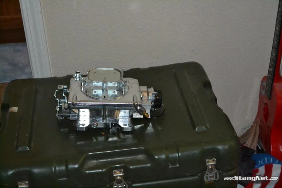

I happen to like my Street Demon 625. It's a simplified version of some old Carter design, but it offers small primaries for economy and a large, goggle shaped secondary butterfly to allow good airflow during hard acceleration. I run it on my 81 408(351M stroked) engine with no problems save what I have caused for myself. It's a set and forget carb with a lot of tuning options for low costs. Runs about half the cost of the Edelbrock carbs.
I have one of these new-in-box under the desk. Was going to end up on a project car that got aborted. It was all of $10 less than the Edelbrock 1406 though.
Now Summit DOES throw reman Street Demons on Ebay with full warranty for about $200 fairly regularly.
I have no idea how well the Demon works, but damn it's pretty!
Works great for my application. Slightly smaller than the recommended 650 CFM the engine builder I bought the kit from recommends, but no issues with the carb itself. My personal adjustments are off for the choke and idle. I'm using an anti-dieseling solenoid on it that is set too high for curb idle. I got it for $325. The Edlebrock and Holleys were running 5-600 for the 650 CFM with electric choke.
