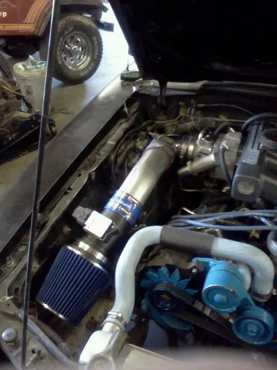

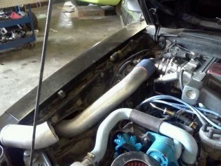

I made mine out of turbo piping from a 7.3 and miscellaneous clamps and couplers from O'reilly's. I really need to make a heat shield, though. So I won't get too much hot air off the fan going into the filter.
That was before I put the filter and MAF on. The pipe already had PERFECT bends, but sadly I was too lazy to take the inner fender out and actually put the filter in there so I just cut it off short and here's how it looks
With filter and the couplers I MAY have $30 in it. And IIRC, the filter alone cost like $21 or so.
